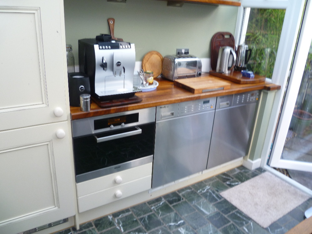

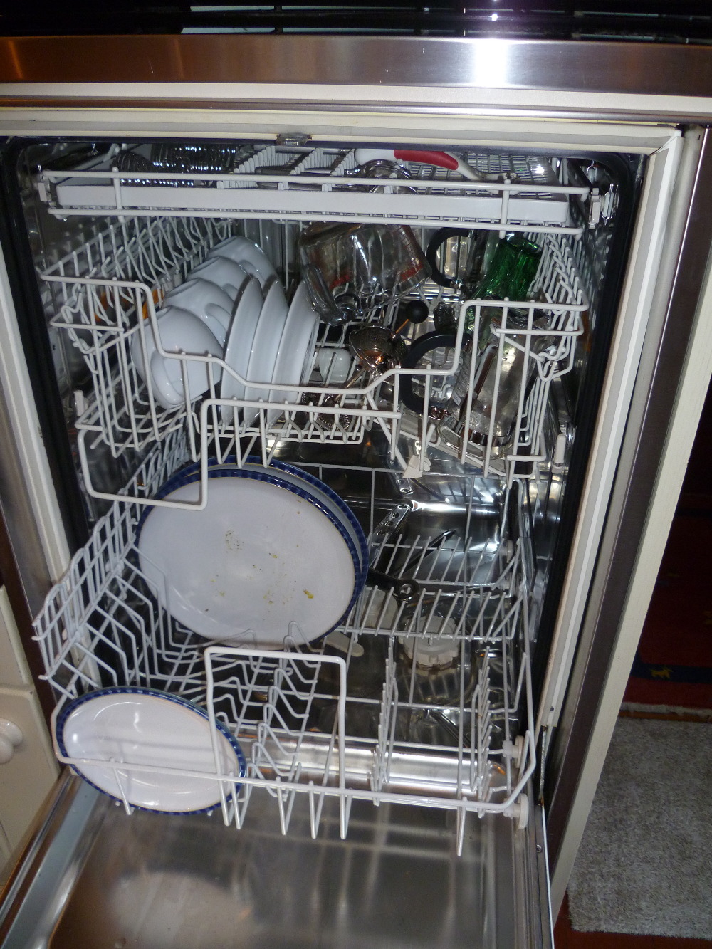

All you need to do is run a hot wash let the machine start filling open the door add 1 cup white vinegar and let it run I do this about every 4/5 weeks my machine look like new after 5 years. I do the same wash the washer as well ![]() |
Post# 547560 , Reply# 17   10/5/2011 at 05:38 (4,678 days old) by MikeKLondon (London)   |   | |

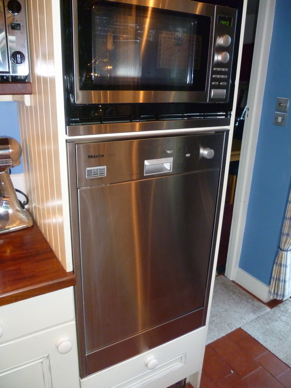

Next Pic ![]() |
Post# 547561 , Reply# 18   10/5/2011 at 05:43 (4,678 days old) by MikeKLondon (London)   |   | |
Washer and Dryer ![]() |
