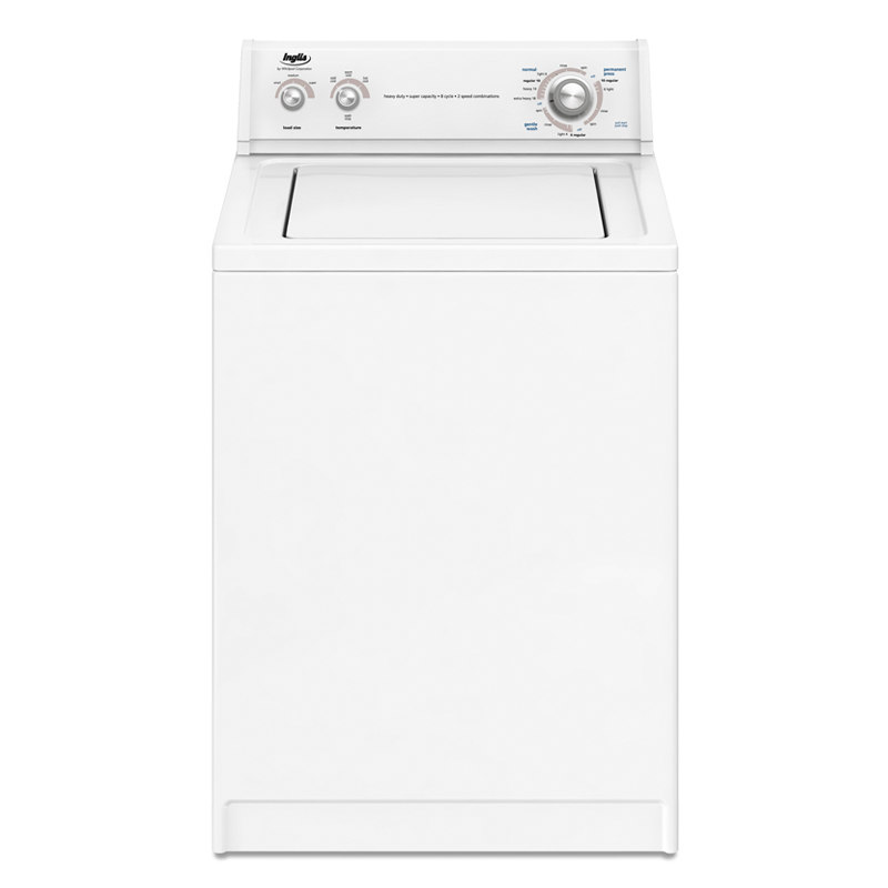

Post# 550896 , Reply# 41   10/20/2011 at 22:15 (4,750 days old) by Spankomatic (Ukiah,CA)   |   | |
Think I will chime in here.... I have used my friends 2004 Whirlpool Duet off and on since they were new. I never have liked them! The washer shakes the house on the final spin. The pump is loud. I don't care for the soap dispencer drawer. The gas dryer has never dryed the clothes completly. The cool down cycle is not long enough and the extended cool down is that on off thing. These Whirlpool dryers are know for the thermisters going out. I had to change it twice now. Both machines are installed properly.
Since I moved into an apartment complex last January.... my Maytag Neptunes have been in storage. When I first moved in I was using the coin laundry here in the apartment complex. It has a brand new G.E. TOP loading washer. It is horrible!! Sounds like a toy and does not clean clothes at all! I have to use twice as much soap in it since it is a TOP loader. So.......I have been going over to my friends house and using her Whirlpool Duets (even though I don't like them) since they do a much better job at cleaning than the TOP loader. I really really miss my Maytag Neptunes. Nice and quiet,easy to use,dryer drys my clothes perfectly with a great cool down cycle. They fit nice,not bulky. Maybe something newer/used might be worth looking at for you. Leave no stone unturned.... |

Post# 551253 , Reply# 45   10/22/2011 at 12:52 (4,748 days old) by DADoES (TX, U.S. of A.)   |   | |
8 cycles on the Inglis pictured above is misleading, nothing more than marketing. It's actually only 3 cycles. The marketing department gets 8 cycles out of it by considering each of the *marked wash times* on the dial as a separate cycle. - NORMAL cycle has (1) Extra Heavy 18 mins, (2) Heavy 14 mins, (3) Regular 10 mins, (4) Light 6 mins - PERMANENT PRESS cycle has (5) Regular 10 mins, (6) Light 6 mins - GENTLE WASH cycle has (7) Regular 6 mins, (8) Light 4 mins There's the (8) cycles, when it's really three cycles starting at longer or shorter wash times. Also, this is a ONE SPEED machine. All agitation and spin is at high speed. GENTLE WASH gets so-called gentle action by intermittent agitation at high speed, which is not the same thing as a true low speed. |
