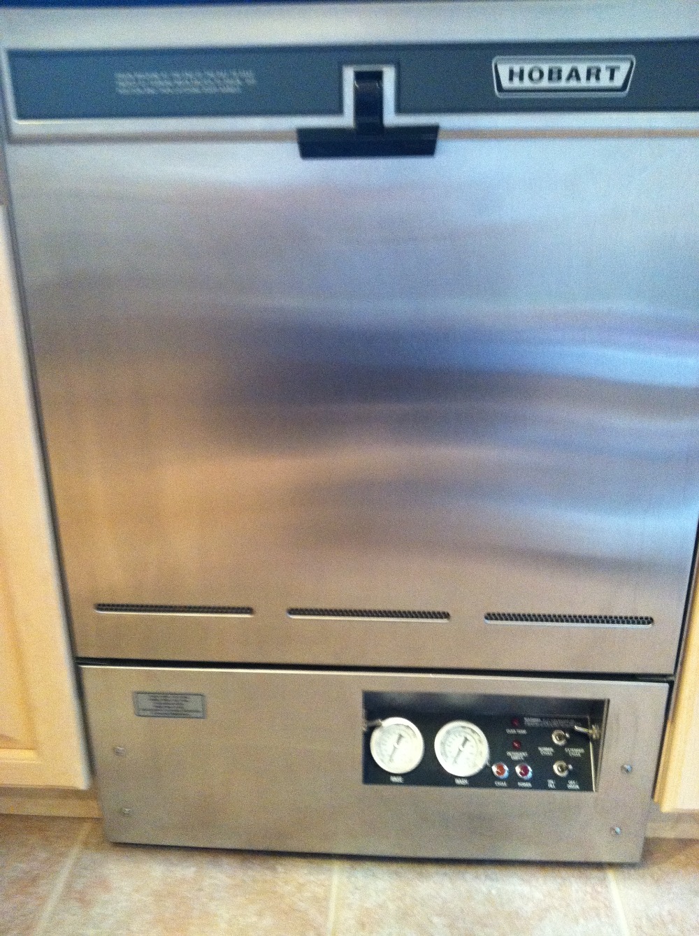

Hobart FFW- Install and Modification |

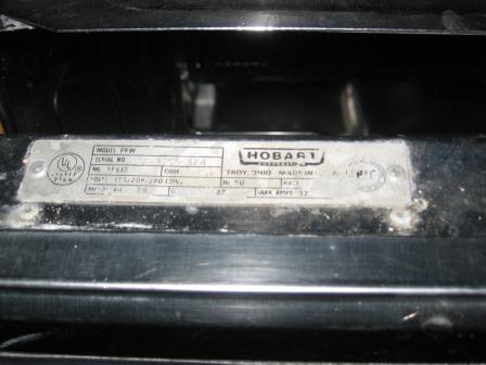

Here is a pic of the serial number plate. ![]() |

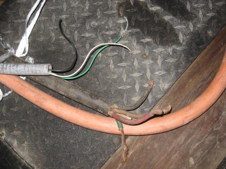

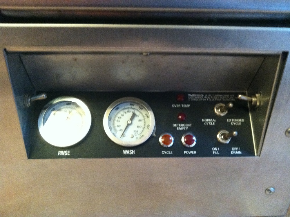

Well I got some 6 gauge range wire and I am going to give it a shot. I am still looking for find out what the 3 120 wires are for and if anyone has put a switch in to shutoff the water heater. Any help is appreciated. |

This is a 3 phase machine, Both the heater and the pump motor are eaither 240 or 415 volt and not 110 volts.
Please get an electrician to look at it as connecting it directly to your 110 system may damage the machine and or your house wireing. CLICK HERE TO GO TO brummybear's LINK |
Post# 549349 , Reply# 6   10/14/2011 at 14:41 (4,669 days old) by stevet (West Melbourne, FL)   |   | |
Please be advised that your machine IS, AND ALWAYS HAS BEEN a single phase machine as produced for North American use. It is not a 3 phase unit as the timer and pump both run on 120 volts. |
