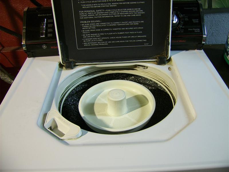

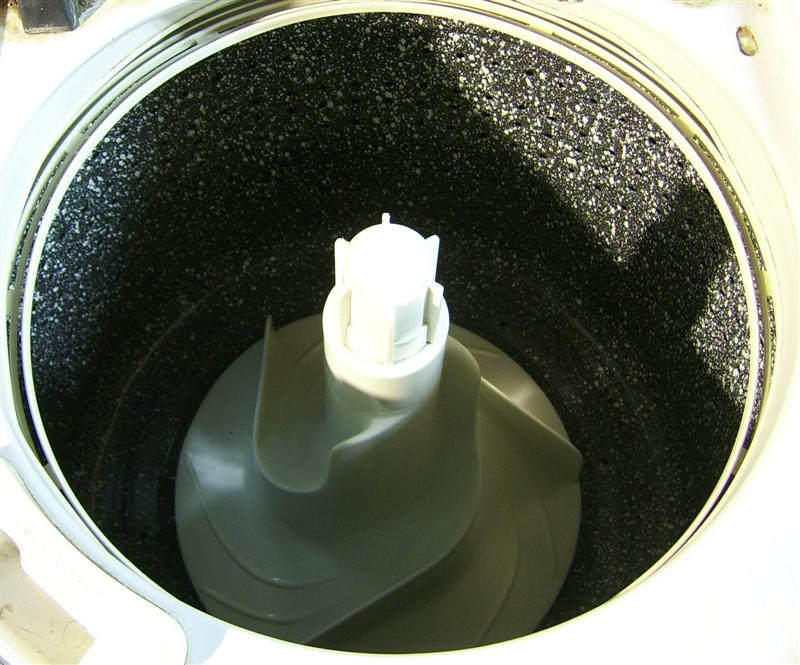

My beautiful GE Filter Flow washer stopped spinning. It pumps out the water but agitates when the tub is supposed to spin. Looks like a transmission problem ? I have not run across that before on one of these.
I am moving and it will be left behind. Free to anyone who wants it. Located in Portland, OR.

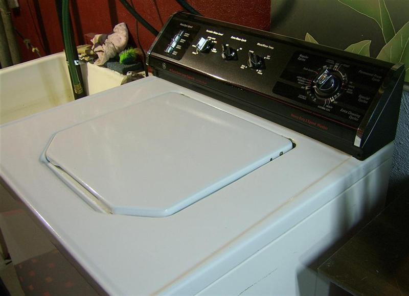

Post# 556035 , Reply# 3   11/11/2011 at 22:08 (4,159 days old) by freewestinghous ()
3rd photo
Inside.

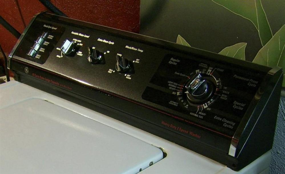

Post# 556037 , Reply# 4   11/11/2011 at 22:09 (4,159 days old) by freewestinghous ()
4th photo
Inside 2.

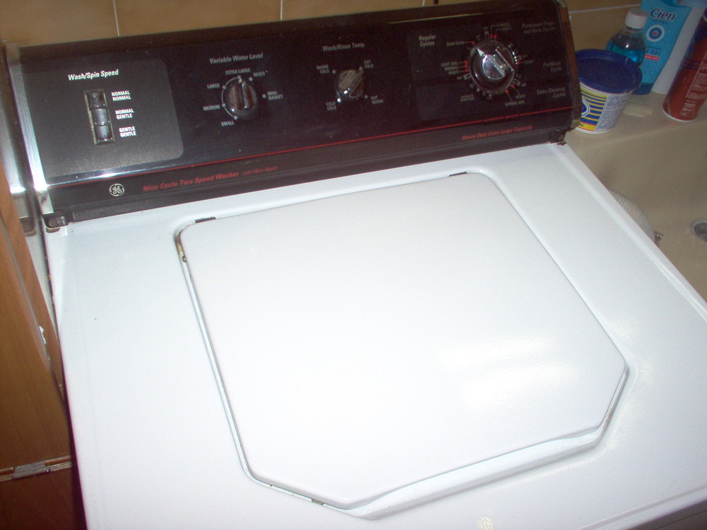

Post# 562880 , Reply# 13   12/12/2011 at 18:59 (4,128 days old) by Kenmoreguy89 (Valenza Piemonte, Italy- Soon to be US immigrant.)
kenmoreguy89's profile picture
Hi I've the model before it! mine just miss one speed button and extra rinse knob, mine is now giving issues due to a bad shaft oil seal again,just replace the lower one year ago, maybe I'll need to replace the whole tranny, is your tranny good??? If yes please save it for me! I'm in Italy and i cannot get there of corse, but I would pay tranny and shipping!!!!
This is a pic of my washer I took one year ago to post on my leaking oil thread:
