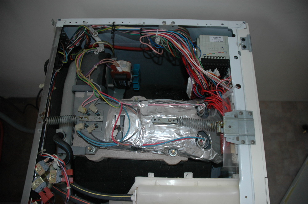

Post# 557597 , Reply# 8   11/18/2011 at 13:04 (4,543 days old) by electron1100 (England)   |   | |
Well i would have totally agreed with the suggestions about the pressure bottle, this is a common fault on old Hoover machines now what about a sticky water inlet valve. Do you have hot and cold fill connected?, when the machine is filling if you have the top off you should be able to hear the water inlet valves buzzing/humming, you will also hear the water level switch click when it reaches the required level of water, if this happens switch the machine off and see if it stops filling,, if it doent stop filling then you have a sticky inlet valve. Thats my suggestion for the next place to look Gary |

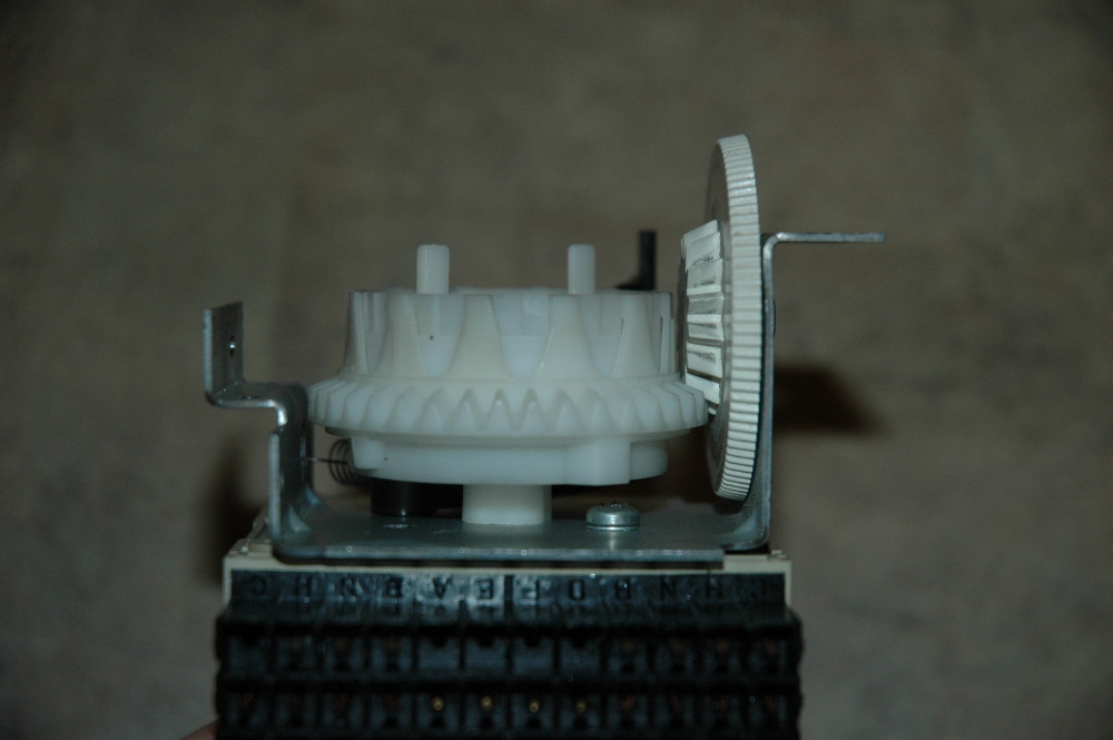

Post# 558704 , Reply# 13   11/23/2011 at 07:54 (4,538 days old) by andyg ()   |   | |
Hi All, Metal plate now successfully removed from old timer. I'll report on the operation of the new timer and the machine later. Regards, Andy |

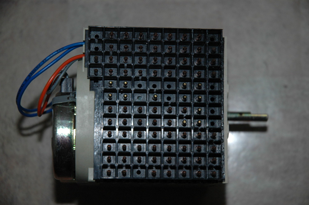

Post# 558978 , Reply# 15   11/24/2011 at 14:44 (4,537 days old) by electron1100 (England)   |   | |
Hello andy
Have a look at each connector and see if the pins match the pins on the programmer, I see some are not there this may help, you might find that one connector only has 3 pins missing and this will go with the programmer connector strip with the same 3 pins missing, dont go swapping them around for the sake of it you could do some damage. Fianlly give me the model number of the machine and the timer and i will see if i have a wiring diagram for it. Gary |
Post# 559300 , Reply# 18   11/26/2011 at 05:53 (4,535 days old) by andyg ()   |   | |
James Nice to hear from you. One photo here, I have more but have to attach singularly. Andy PS. I do pray someone can help me with the wiring issue ! |

Post# 560379 , Reply# 20   11/30/2011 at 11:39 (4,531 days old) by andyg ()   |   | |
Hi All, Does anyone have any ideas on the wiring of the timer please? From one really grateful, Andy on St Andrews day. |
Post# 560801 , Reply# 23   12/2/2011 at 09:16 (4,529 days old) by ozzie908 (Lincoln UK)   |   | |
Post# 560940 , Reply# 25   12/3/2011 at 11:14 (4,528 days old) by electron1100 (England)   |   | |
Hello Andy
I have sent a scan to the email address you have on here of the wiring diagram for the timer you have in your machine, this timer it would appear was fitted to various machines of that type. It might take you a while to get to grips with it but it might help. with regards to re-fitting the old timer to see if the programmer constantly rotating problem goes away why not, go ahead. one other question, when you were looking at the water pressure bottle did you blow into the rubber tube that goes up to the water level/pressure switch, if you blow into it you should hear two clicks from the level/pressure switch these being the two pre-set water level switches inside the level/pressure switch, if you hold the air in tube as long as you can to see if the air is leaking out, it is just another thought, if the switch was faulty or the air seal on it, or the tube was leaking this again would cause the problem you have. Gary |
