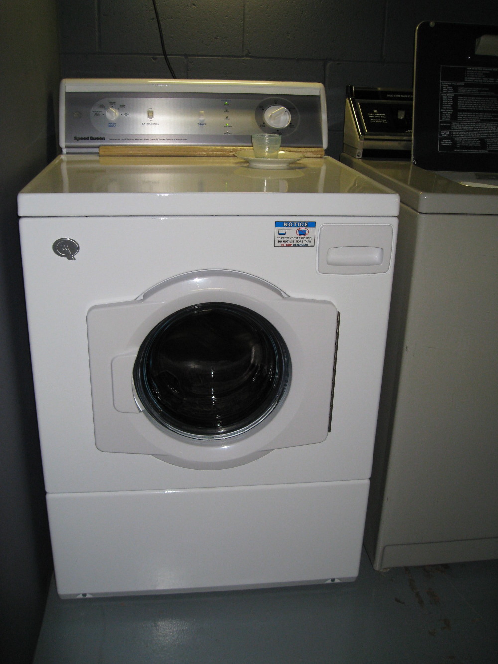

I'm not quite sure what you mean....
A front loader IS A horizontal axis (H/A) machine.
A top-loading H/A machine could be what you mean and there are a few differences between a Front-load H/A machine and a Top-load machine with the same wash action, that is a tumbling action rather than an agitator one.....
- Front-load has bearings at the rear of the drum only - Top-load H/A may have bearings either side of the drum - Front-load has a porthole door with a rubber boot (most cases) or door seals against outer drum (ASKO) - Top-load H/A has access via the top. This is normally via 2 doors - outer which may contain the detergent dispenser and inner, which is the actual wash-drum of the machine. A rubber seal exists here too. - The vast majority of Front loaders sold globally are 60cm wide, with Nth American machines (and some Korean and one European one being a tad wider - Samsung/LG/Whirlpool) - Top-load H/A machines are normally between 40-45cm wide depending on brand and capacity (Staber excepted). - Front-load machines can be accessed as soon as the door unlocks - Top-load H/A machines may require the user to manually move the drum to access the inner door (though many also return the drum with the access door facing up)
Given that it sounds as if there is a very limited (Staber only?) supply of Top-load H/A machines sold in either Canada or North America, how on earth can you say:
'...but I know it'll be more reliable'?
I would suggest, though can't prove it, that there would be very little difference in overall reliability between Front-load and Top-load H/A machines made by the same manufacturer particularly given that electronics, motors and other mechanisims, including bearings, are likely to be the same specification for a given price-point.
To conclude, these machines are not popular here and I doubt that any are currently listed for sale. They are, however, popular in parts of Europe, particularly France.
Over to you, my European colleagues! |

Post# 560764 , Reply# 34   12/2/2011 at 02:24 (4,527 days old) by ronhic (Canberra, Australia)   |   | |
From a European perspective, probably because they can't be built under a bench or integrated into a kitchen....
From an Australian perspective, there has only been one or two sold here...both were expensive and had a smaller capacity AND lower spin speed than was expected for the money.
I've used a Baukneckt in Germany some years ago that would have been at least 15 years old - lovely brown beast it was....relatively quiet, cleaned well and had provided my partners grandmother faultless service. |

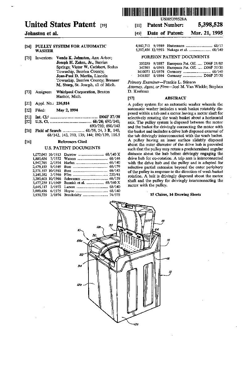

Post# 560767 , Reply# 35   12/2/2011 at 03:54 (4,527 days old) by Launderess (Quiet Please, There´s a Lady on Stage)   |   | |
For both commercial and even domestic use had top loading H-Axis washers. Heck I've seen photo's and also are included in my vintage laundry manuals are models with tubs made from wood.
The advantage is was easy to see then in that such *pony* washers didn't require water tight seals the way modern front loaders do today. As for modern "pocket" washers (large H-Axis washers are often divided into compartments beneath the bonnet),the advantages are easy to see. First such machines are easier to load and unload than a similar sized front loader with a boot, especially as one goes up in capacity weight. For commercial laundries in hospitals and or those that frequently do infected/hospital linen these units can be built into a wall where one has a clean and dirty side. Despite their advantages top loading "H-Axis" washers have had limited market penetration in Europe and are virtually nil on this side of the pond except for Staber. One big drawback is that once one goes over a certain capacity the drum must switch to a side to side design. This would be fine for a small washer but to handle large loads you're likely looking at a unit whose cabinet won't fit the standard 24" (or whatever it is) width of American top loading washing machines. With toploading H-Axis washers of a small size such as those sold in Europe by Miele and others the drum is recessed and thus one has a flat surface. By nature *pony* washers have drums/tubs that are raised and covered over. This means giving up that flat surface. Now one could lower the tubs but that means for a washer of any decent capacity (to compete with the 18 or pounds an Amercian top loader holds), but then you are going to have a very deep tub with perhaps a small opening. Not something your average Mrs. American housewife may relish on laundry day trying to fetch out items from the bottom of the tub. |
