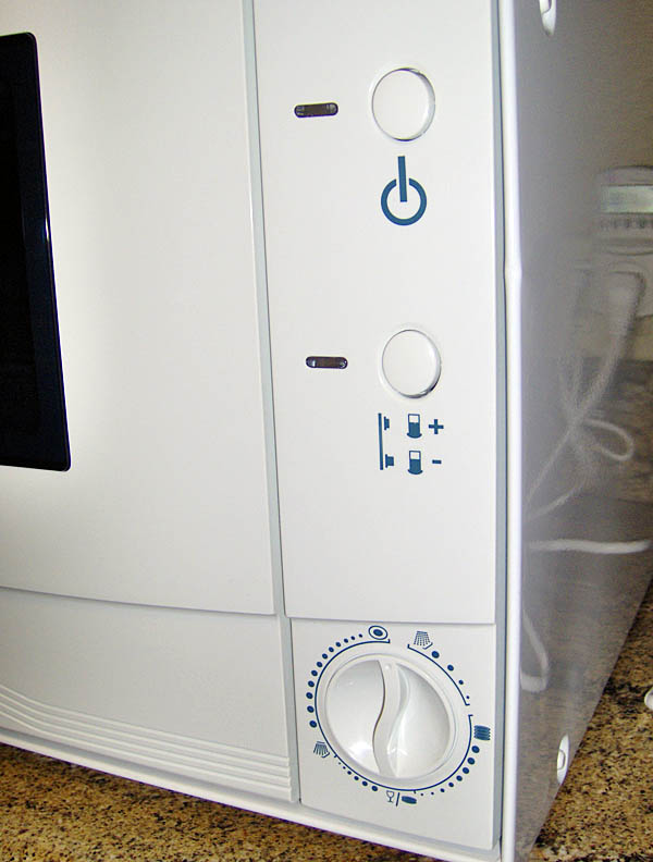

Controls. Power button, has a green light. Econo/Sani button has a red light. Econo runs at tap-temp except the final rinse is always heated to 160°F. Sani heats the first wash to 160°F (delays the timer as needed) and runs the heater for the 2nd wash (not temp-delayed). The first rinse is never heated. |

Timer has two cycle sections. Rinse/hold (Danby calls it PreWash), runs an unheated rinse, drain, off. Main cycle has three designated starting points (with detents). Each starting point begins with a drain. The first wash is longer, second wash shorter. Two rinses are in the last timer section, one short, one longer. Normal = Wash, Wash, Rinse, Rinse. Or can be (pre)Rinse, Wash, Rinse, Rinse except the prerinse would heat to 160°F in sani mode. Short = Wash, Rinse, Rinse. Quick (Danby calls it a Rinse only) = Rinse, Rinse. Or can be (tap-hot/cold Wash, Rinse. There is no dry period as such, it simply drains (for two final timer increments) and shuts off. The water level is sensed by pressure switch, not timed. Manually resetting the timer to a fill point it skips (apparently with a momentary rapid-advance) to the next timer increment. Cutting back the faucet flow to a trickle, it fills as long as necessary to reach the target level. |

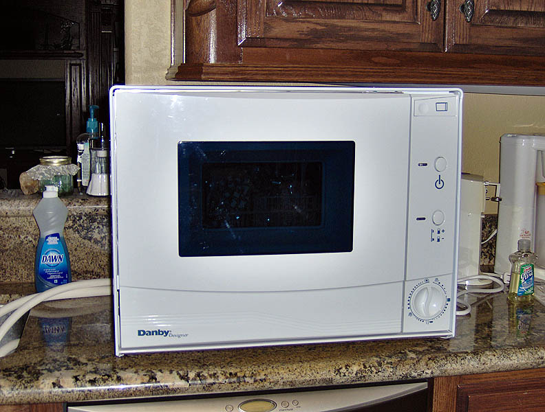

Nice machine. This is the best Danby counter-top they made, very heavily built as you will notice of you disassemble. This machine has a separate drain pump in it and heavy vinyl coated teal racking. It also has a motorized detergent dispenser in the door letting you have a REAL prewash and wash instead of the 397 and 497 models just having a stupid indentation for detergent in the door. There are some Bosch parts in this machine. This is the ONLY Danby to consider IMO, it's a good machine. My 396 was made in 2000 and sat outside on a back porch for 5 years and I still got over 2 years of use from it (heavy use, 2 people, twice a day running). The pump got real tight on mine and the motor wouldn't always start up on it's own, they are not that easy to work on unfortunately. The dispenser door operates on the "Short Wash Cycle" only, using the Normal section as prewash. The heater is thermo-controlled and will stop the timer until it comes up to temp and helps greatly. The dark glass is removable but requires taking the door apart, which should be done anyway to check the condition of the rinse aid dispenser, which can sometimes leak.
Nice find!
