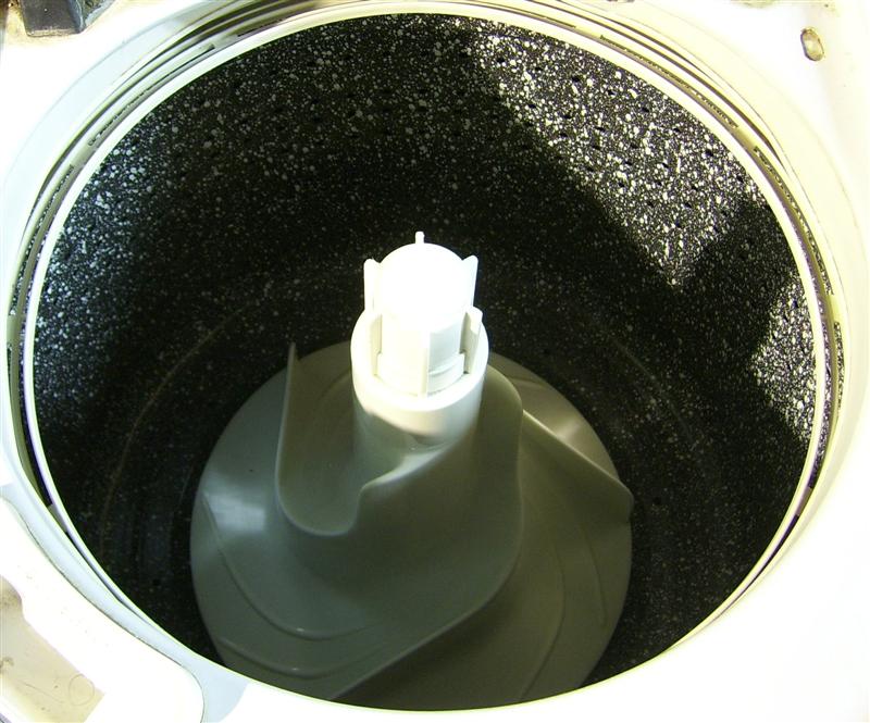

Removing GE Flter Flo agitator |
Post# 559850 , Reply# 1   11/28/2011 at 03:05 (4,624 days old) by yogitunes ![]() |
this could be one of those that have a bolt under the cap, pop off the extension, and remove the bolt, then it should slide off.....this is actually a small capacity agitator, with the extender to make it larger.....if memory serves me right...the bolt is holding the agitator and the extension, look for the seam along the small cap/cover along the top, pop this off and the bolt should be inside....
