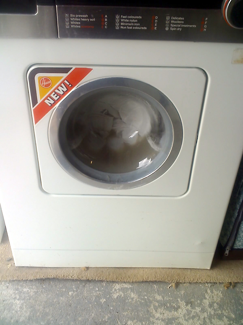

is there a away to modify your washing machine to use more water for a standard washes |
Post# 565388 , Reply# 1   12/27/2011 at 10:44 (4,497 days old) by electron1100 (England)   |   | |
I have a Hotpoint Aqualtis, on this machine there is a program for "Shirts" this is a very high level wash (like old 70s/80s) machine levels once it has finished filling i turn it off and then select say "coloureds " wash if i want high water levels on the wash. Or I can restart the program after it has decided that it has gotten the water level it wants, when you restart a programme it automatically fills with a pre-set amount of water regardeless of any water in the tub. Failing all that i go to my garage and use one of my old 60s/70s or 80s machines that all have excellent water levels, and are fully adjustable if wanted this is a fot of the high level used for the end of washing and rinsing on my old Hoover A3110 1100, and as you can see it gets dirt out ;-) |
