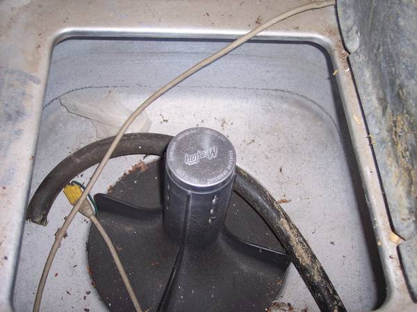

Hi all saw this on CR. I know a lot of you would like to have one of these agitators. I already have one and really like it. It's located in Millstadt, IL which very close to St. Louis. Steve CLICK HERE TO GO TO shankstr's LINK on Stlouis Craigslist |

The agitator for the conventional washer will not fit the automatic washer and vice versa. |

Has anyone tried contacting this guy? Maybe he will part with the agitator only, if it will come off?!?! Also, I believe Tomturbomatic is correct about the conventional agitator not fitting the automatics. I think there is a post height difference and or spline difference? Steve |

No, the agitators are not interchangeable. The wringer agitators had a "cup" on the bottom of the agitator to extend down over the shaft that created the air bubble to keep water away from the shaft and seal assembly. This will not go into the automatic machine because of the shape of the tub bottom.
I've seen a couple of these filter-agitator wringers over the years at sales, some not much better looking than this one for exorbitant asking prices and just kept walking. One helper at an estate sale caught me looking at one a year or so ago and started the hard-sell routine and I told her for a machine in (that) condition their price was way out of line. They are still too common around here. |

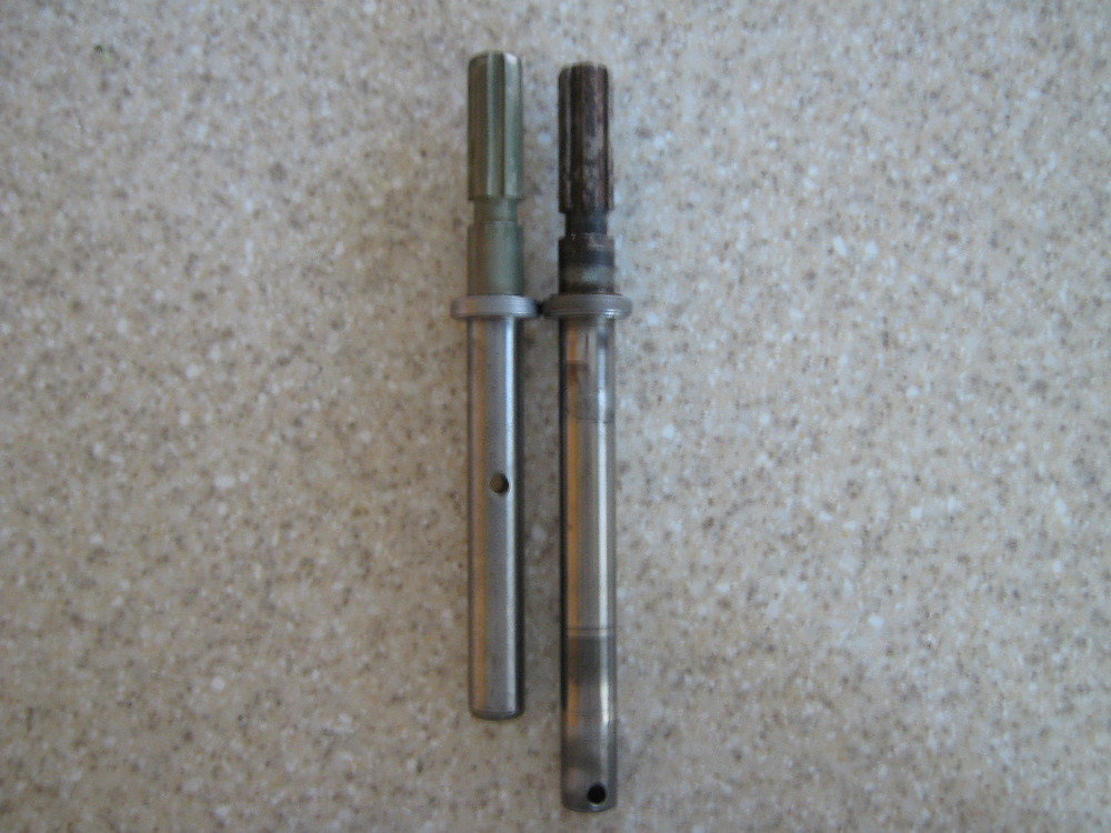

![]() While the shaft diameter, splines, and lower sleeve bearings are the same between autos and wringers, the lengths are quite different. Notice the splines and agitator seal are positioned slightly higher on the wringer shaft. It's a shame Maytag didn't share the the same shafts and lengths (at least the same protruded spine lengths and agitator seal positions) between wringers and autos like they were known to do with other parts between the two. This would have been very convenient for us, especially since Maytag provided replacement shafts and sleeve bearings for wringers. This was not the case for automatics (had to purchase the entire upper transmission housing).
Here's an NOS E/J/N wringer shaft on the left and a used automatic shaft on the right. Can you spot the differences? ![]() |

Great picture, Dan! Did you use a press to get the pin out of the automatic shaft? I banged on the shaft from my 606 for a while before just chucking it and replacing the whole top - as per factory doctrine - but I wanted to see...

![]() It takes a very large and heavy duty punch along with a 10 pound sledge. If you hit the pin head on perfectly perpendicular, hard, fast, and precise, the pin will actually glide right out. I was blessed with that occurrence only once. I usually end up beating the crap out of 'em.
By the mid 70's, Maytag began using a full length splined pinion gear which recessed the pin. This greatly helps keep the punch from flying off the pin while banging away. It also gives the idiot with the sledge more confidence to hit the pin harder :>)
