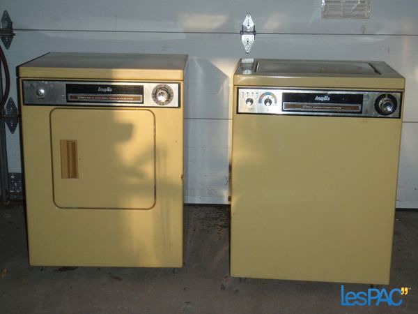

Whirlpool "Compact" W&D, also sold under "Kenmore" brand as well.
For through cleaning and rinsing you cannot beat the vintage Whirlpool "Surgilator" beater. Older units had a slightly faster final spin speed than modern units so things emerge a bit dryer. The portable dryer hasn't changed much over the years but are true work horses. IIRC wattage is <1500 or so but will get the job done long as one is careful about loading. To speed drying times you might look into getting a stand alone spin dryer. |

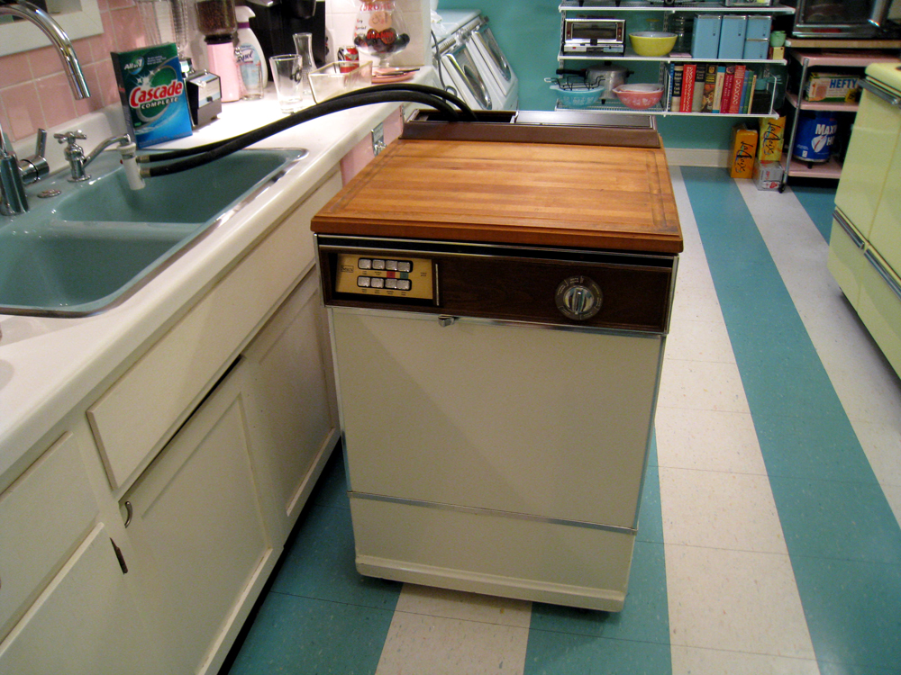

Piere, there is a portability kit for the 24" front loaders. It has the casters that can be retracted and the unicouple device. You have to hook up only the cold water intake and set the temperature of the incoming water manually at the faucet. Similar to a portable /convertible dishwasher. It has to be special ordered.
