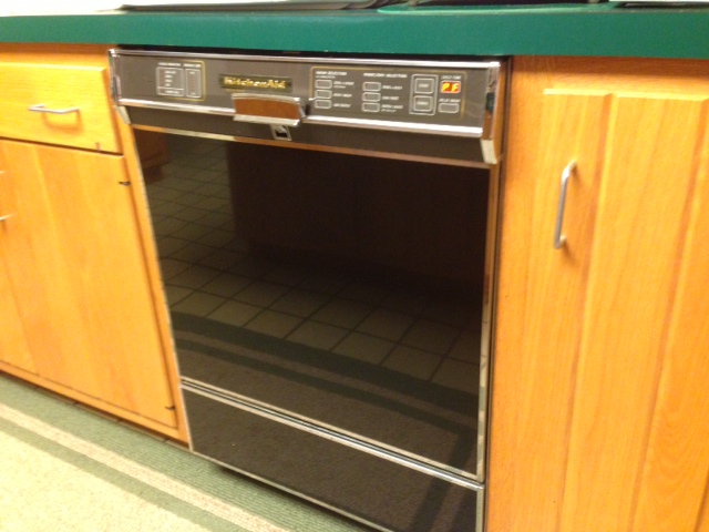

Anyone want Kitchenaid KDSS-20 Selectra Dishwasher? |

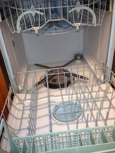

Interior and lower rack. ![]() |

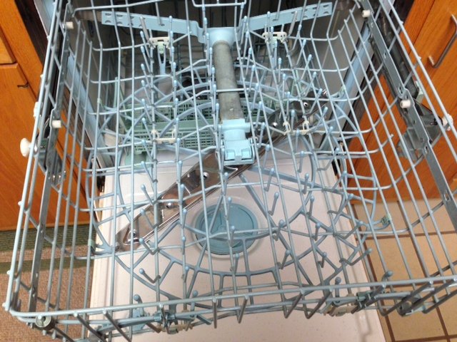

Upper rack. ![]() |

It looks very clean! I hope someone can find a use for it. |

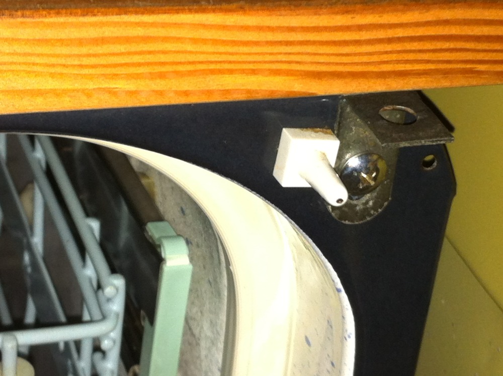

If the PF light is not clearing when you close the door latch and hit cancel, I wonder if it is just a faulty switch.
Have you checked to see if the plunger (upper right corner of tank) that pushes the switch in on the back of the door is still there? Some are made of plastic and have been known to snap off. It is a very simple fix if that is the problem. ![]() |
