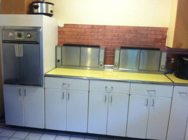

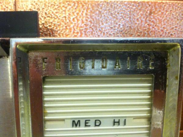

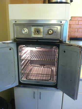

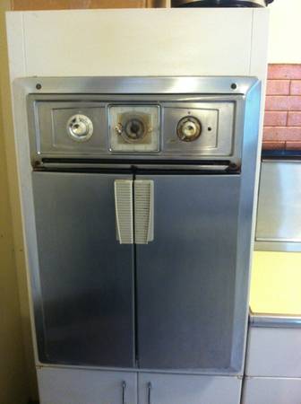

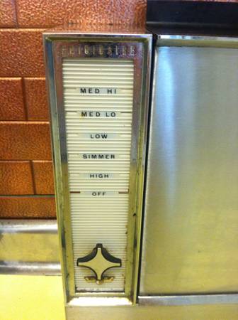

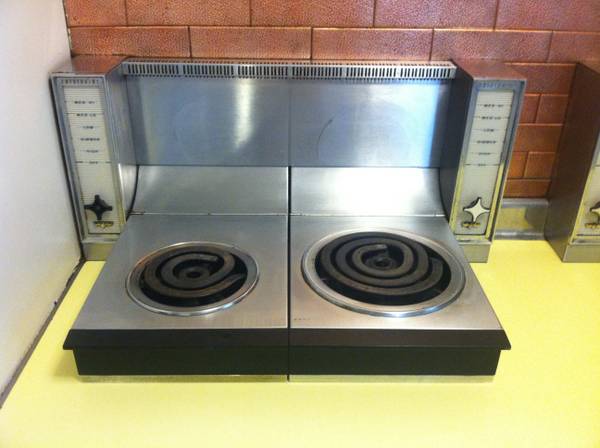

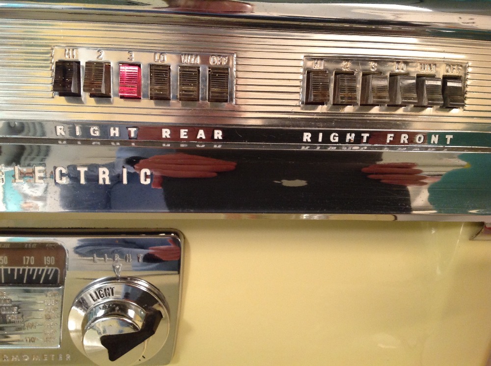

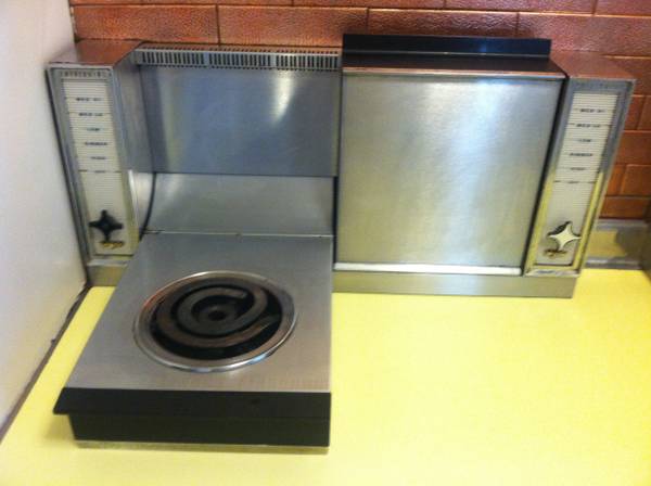

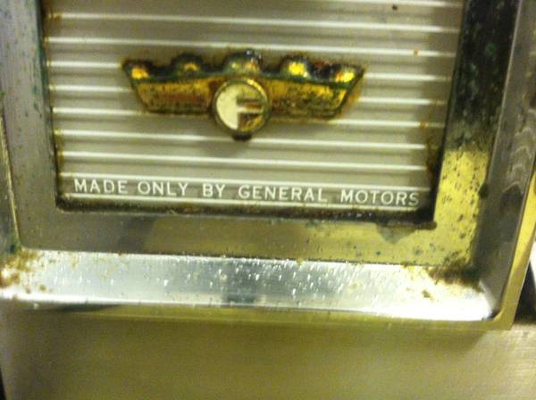

![]() 2
Here are photos for the Archives, and a bit of a whine:
When you post a link to an ad, and don't post a photo for the Archives, you are leaving a hole in the Archives for the future. Someone else, later on, may be in desperate need of the info a photo can give them. Please consider taking the moment to post a pic when you post a link. If you've ever used Super Searchalator to run down information on something rare, only to find that the post Super Searchalator brings up has only a dead, three-year-old CL link, you're familiar with the frustration I'm talking about. These Frigidaire drop-down units are pretty scarce; seems to me we should have some photos. Now for the pics: ![]() |

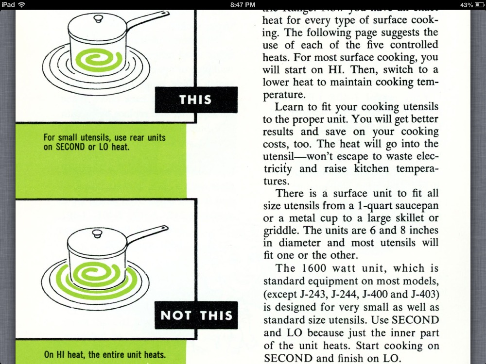

Post# 702636 , Reply# 12   9/11/2013 at 08:39 (3,971 days old) by Kenmore71 ![]() |

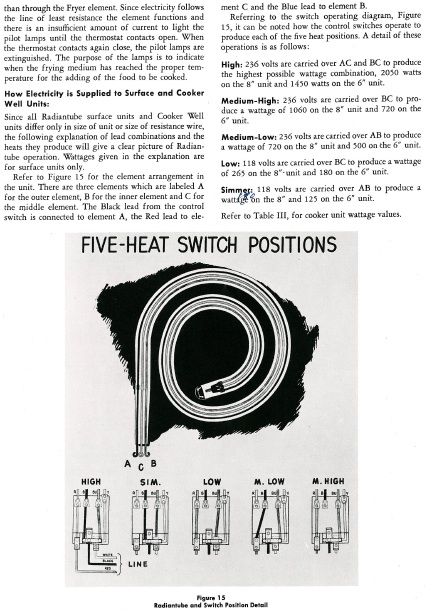

![]() According to Frigidaire literature of the day, this placement was VERY intentional. The 3-wire monotube RadianTube elements (used from 1949-1959) were notoriously slow to heat up, especially on the lower temperatures where they did not receive full voltage. Part of learning the "knack" of cooking effectively on these (which my grandmother and mother did until the early 1980s) was that ALL cooking operations begin on HIGH and then move to a lower temperature once the desired temperature was achieved.
I remember that it took my mother a while back in the early 80s to adjust to her new Roper-built Kenmore range with its full-240 volt Calrod-style elements on infinite heat switches.
Here is a statement to that effect from a 1955 range owner's manual: ![]() |

Post# 702705 , Reply# 17   9/11/2013 at 14:35 (3,971 days old) by Kenmore71 ![]() |
![]() These wide RadianTube burner elements had 2 separate elements in them that ran parallel to each other with a third return wire. Through the 5 position heat switch 240 OR 120 volts were introduced across various combinations of the elements. On this particular set, the 8" unit would consume 2050 watts when both elements were connected to 240 volts in parallel and the 6" element would consume 1450 watts. Here is the detail: ![]() |

Post# 703760 , Reply# 24   9/17/2013 at 20:49 (3,965 days old) by HooverWheelAway ()   |   | |
Never mind... The manual does actually say that 2 is hotter than 3... Which is stupid. Shame on GE! LOL Now that I look again, this is the part about the burners that confuses me.. To much to think about! ![]() |
Post# 703771 , Reply# 25   9/17/2013 at 21:56 (3,965 days old) by norgeway (mocksville n c )   |   | |
Old ranges were this way, I have seen several that 1 was hottest and 7 was coolest, makes no sense to me and I cant think of which brands were this way, I want to say some of the early Sears were. |
Post# 703780 , Reply# 26   9/17/2013 at 22:26 (3,965 days old) by PhilR (Quebec Canada)   |   | |
Even with the infinite switches and the slightly faster-to-heat two-wire Radiantubes that go with them, I often start mine on high at first when I want them to heat more quickly. Otherwise, the infinite switch will cycle them off before the cookware has reached the desired temperature (with the exception of the "Speed Heat" which I have on only one of my Frigidaire ranges).
And Fred, the reversed positions of the "2"and "3" settings on your range remind me the settings on the Enterprise range that my parents used to have. This one had infinite switches with "HI" and "SIM" but the numbers between them were a bit counterintuitive as "1" was the highest setting after "HI" and "9" was the lowest after "SIM"! Later versions of the same range had their knobs reprinted with numbers in the reverse order, which was more intuitive! Other weird counterintuitive settings were those on the cold controls on most old Frigidaire fridges like ours! |
