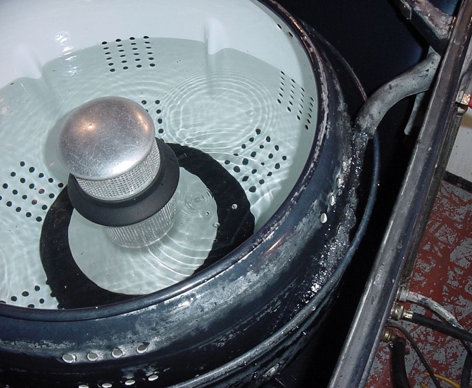

Yes the 1947 and 1948 Frigidaire Unimatics had a double spin tub, the inner liner was perforated and the outer shell was solid. This still operates like solid tub washer, even though it looks perforated. The washer spins both tubs to throw the water out into the cabinet. You can see the double tubs and the water filling between the two in this picture... |

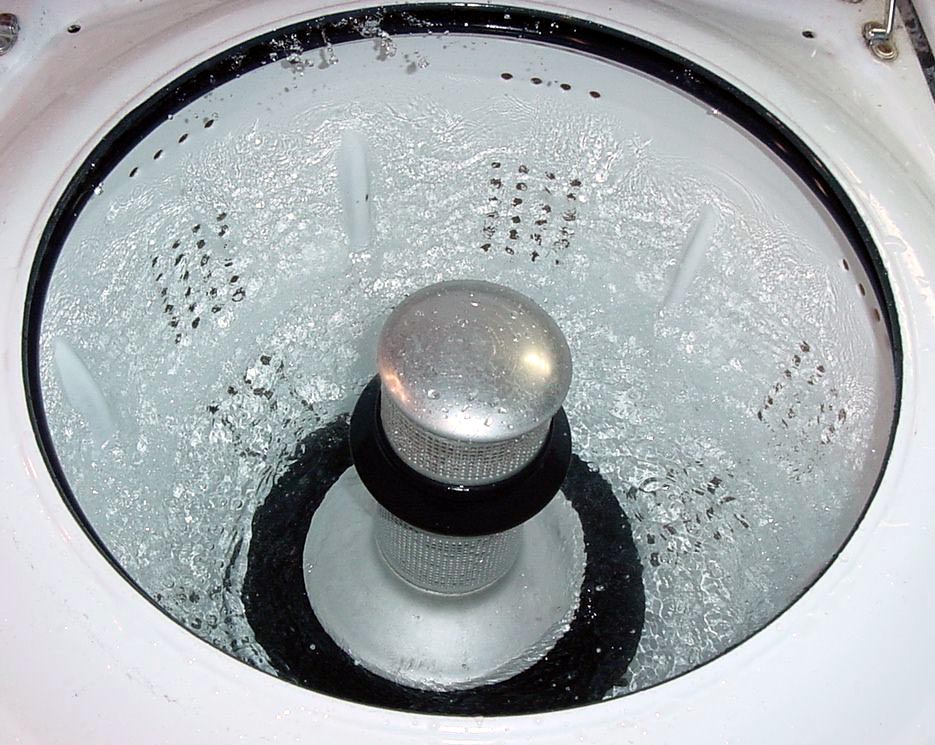

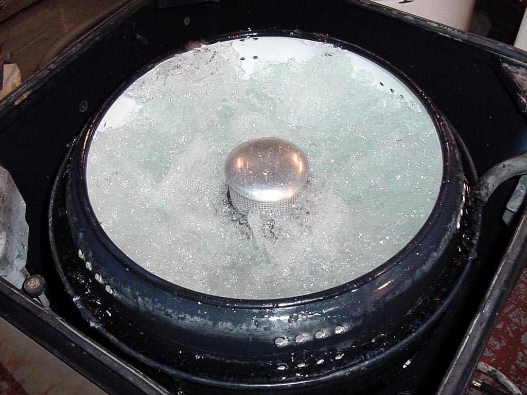

Thanks, Robert, for those interesting and informative snapshots. Lawrence/Maytagbear |

The water currents in this particular Frigidaire look very powerful.That must be some splash fest. |
