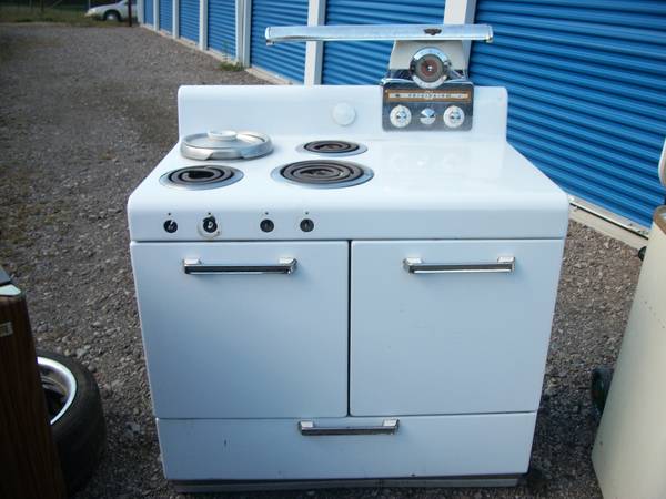

Post# 707414   10/5/2013 at 17:42 (3,947 days old) by moparwash ![]() |
Just the thing to match the dishwasher

Post# 707427 , Reply# 1   10/5/2013 at 18:57 (3,947 days old) by danemodsandy (The Bramford, Apt. 7-E)   |   | |
Unless I am greatly mistaken (there are real Frigidaire experts among us, so they'll tell me if I'm wrong), that's not '50s, it's '40s. It's the single-oven version of the 1948 TOL we had when I was growing up. Raymond Loewy designed it.
Damn thing weighed more than a Hyundai does today - all porcelain, and heavy-gauge sheet metal, plus a fair amount of chromed pot metal. |

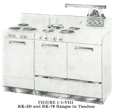

![]() Sandy, the range in the ad that you show IS indeed the TOL 1948 double oven range. It was the model RK-70 and is listed and shown in the 1948 service literature. Note that 1948 was the last year of the thinner, interwound surface elements on Frigidaire ranges. In 1949 the 3-wire radiantube was introduced across the line.
Here is the picture from that manual (shown in tandem with an apartment range, for when you just must have 3 ovens and 7 surface units!): ![]() |

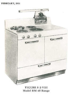

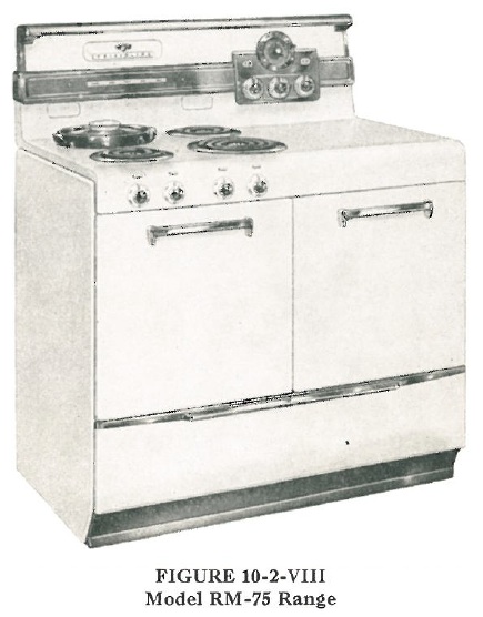

![]() The TOL, double oven range for 1949 was the RM-75. Note that it has the fat 3-wire radiantube surface elements and a completely redesigned full backsplash panel.
It appears as though Frigidaire "repurposed" the TOL 1948 double-oven design for the middle-of-the-line single oven 1949 model, the RM-45. ![]() |

Post# 707958 , Reply# 19   10/8/2013 at 12:46 (3,944 days old) by PhilR (Quebec Canada)   |   | |
![]() There's a very similar range for sale around here (with newer style handles). CLICK HERE TO GO TO PhilR's LINK |
Post# 707970 , Reply# 20   10/8/2013 at 13:36 (3,944 days old) by danemodsandy (The Bramford, Apt. 7-E)   |   | |
Looks like Frigidaire may have carried this styling over for a couple of years - there are detail changes seen on this one that aren't on the 1949 service manual's photo of the RM-45. The oven handles are one, but this unit's storage drawer also has the full-width garnish molding first seen on the 1948 RK-70 - but not on the RM-45. The Radiantubes seen on this unit mean it's definitely post-1948. This is also most assuredly a single-oven unit, as evidenced by the single oven vent (the round disc-shaped object on the backsplash).
