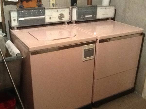

Post# 713201   11/4/2013 at 17:23 (3,917 days old) by agitatorboogie (Denver)   |   | |
![]() 3
Here's a pink pair in my neck of the woods....I called the seller but no answer; left a message. My instinct told me "ALL FOR IZZY, ALL FOR IZZY, TELL NO ONE" but i simply must share with ya'll...it's the only pic
CLICK HERE TO GO TO agitatorboogie's LINK on Denver Craigslist ![]() |

Post# 713270 , Reply# 4   11/4/2013 at 23:23 (3,916 days old) by washdaddy (Baltimore)   |   | |
That's the first time I've seen a dispenser mounted on the front of a top loader that I can recall. Was that a time release or just pure into the outer tub? They are definitely sweet looking machines. |

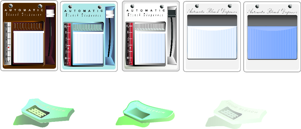

I didn't completely read Izzy's first posting on these so he gets right of first refusal. Although it's academic at this point because she hasn't responded yet to either of us.
GE's first bleach dispensers, offered on TOL's from 1960 to 1964 were complicated pump/reservoir units where access was mounted on the front of the cabinets. The reservoirs held 3 quarts of liquid chlorine bleach and the user would pump, in 1/4 cup increments, the amount of bleach desired for the load from the reservoir into a holding sump for the dispenser. A solenoid would release that bleach late in the wash cycle. We have learned from John LeFevre that there were some problems related to this design including rust caused by having a pool of stagnant Chlorine bleach so close to metal parts. The design changed slightly in late 1962, and that is what's mounted on this pink washer. What I don't know at this point is whether they changed only the escutcheon or the whole dispenser was changed. There are a couple of members who have Filter-Flo's with this dispenser, so maybe they will chime in. ![]() |
