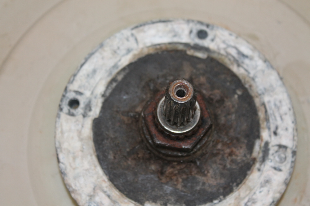

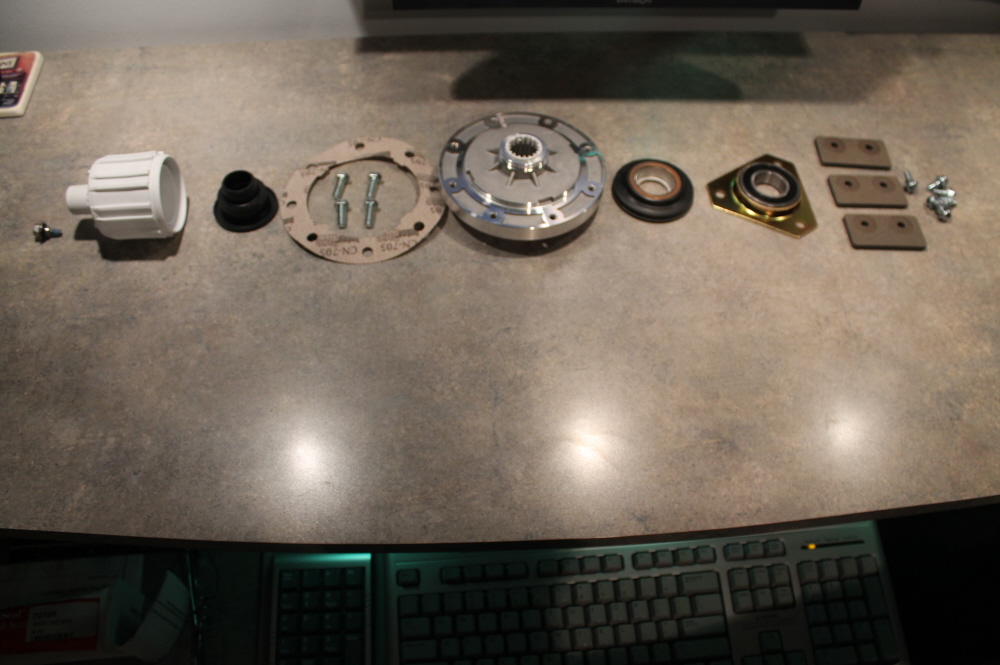

I am replacing the bearings, spin hub, seals and belt etc. on a (I think) 1999 Amana Automatic Washer. Could anyone PLEASE tell me which direction this 1 1/2" nut is supposed to turn to remove??? This would be looking from the top of the tub down. Does it turn counter-clockwise (lefty loosy) or what? I have soaked it for a week with penetrating oil and it won't budge...
Any help would be appreciated! Rick |
Post# 732217 , Reply# 1   2/1/2014 at 10:45 (3,737 days old) by thefixer ()   |   | |
Counterclockwise |
Post# 732319 , Reply# 2   2/1/2014 at 18:05 (3,736 days old) by crevicetool (Snellville Ga.)   |   | |
The nut was removed in a counter-clockwise direction after clamping the transmission to the super structure, and putting a 3/4" iron pipe through said super structure onto which I placed my 189 lbs. of human being so that the entire assembly would not rotate. Then by using a 24", 1/2" drive breaker bar with three extensions attached, the nut finally loosned it's grip on the splined shaft. Quick use of an automotive gear puller demolished the spin hub and it was necessary to chisel/pnuematic grinder that off into about thirty pieces, of course supporting it against the outer tub with plywood to as to not cause undo stress on the two shafts. Other than that, it went quite well. Tomorrow, I will begin the task of cleaning everything so that I can bring the parts home Monday night and begin the reassembly. The motor is good and spins freely both directions at both speeds with no side-play so I am hoping to get another fifteen years out of this machine.

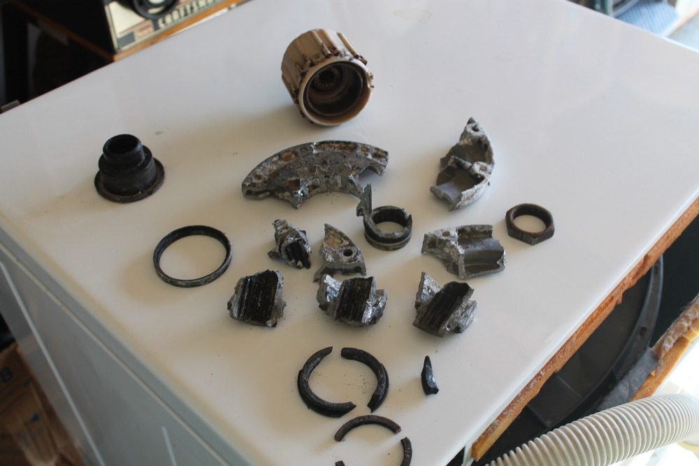

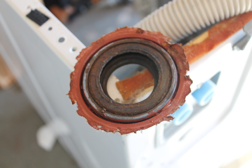

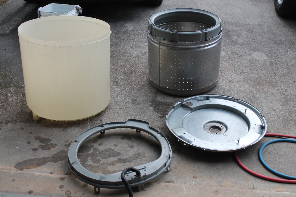

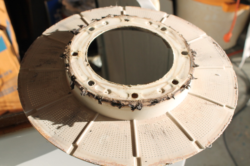

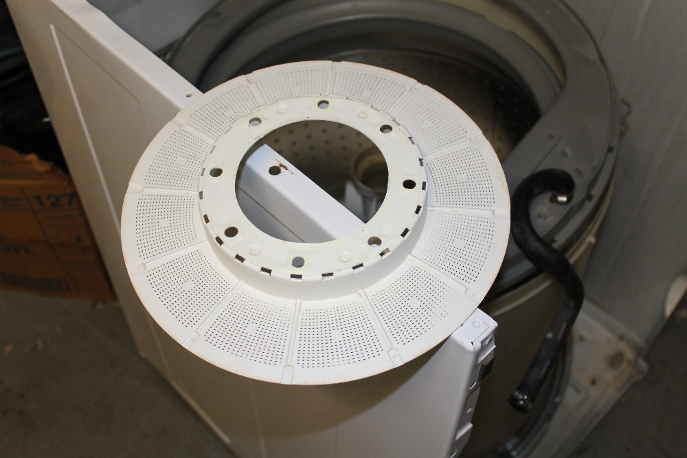

this ain't a DD Hoover triplet-tub, or a Apex Duo-Matic. Nothin' special like that. It is in fact a 1999 Amana washing machine (I understand built by Speed Queen) and it's just a plain ole' washing machine. Nothing fancy.
I had to dig out some of the parts from the trash as I didn't think anyone would be interested in seeing any part of this...and it's not a restoration, just a repair. So, here's what's left of the spin hub, (BTW, pardon me if my washer language isn't up to you guys' level)seals, and bushing. Believe it or not, I only damaged one spline on the spin shaft, and was able to grind it sorta back in shape so I don't think it will impede the installation of the new hub. |

Post# 732545 , Reply# 10   2/2/2014 at 20:01 (3,735 days old) by washman (o)   |   | |
that looks ugly. You sure have your work cut out. |

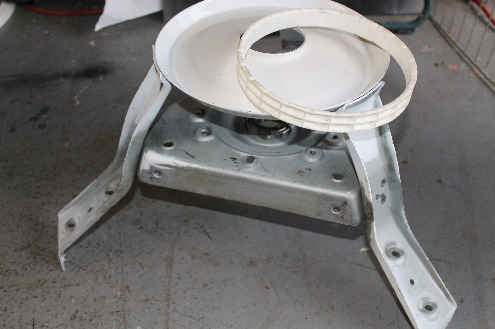

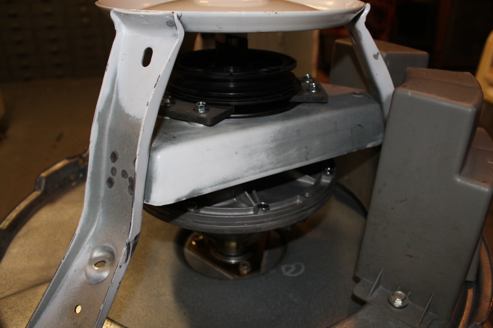

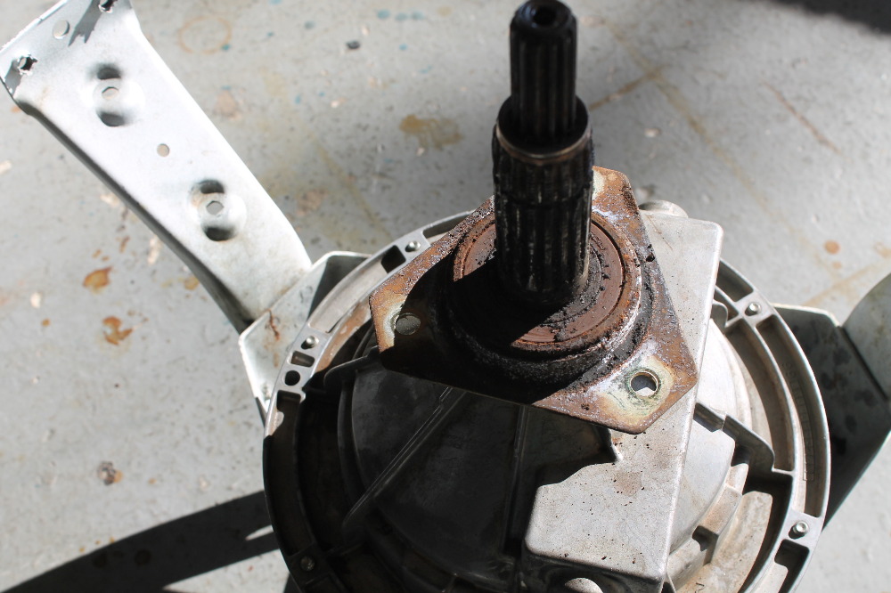

Post# 732547 , Reply# 11   2/2/2014 at 20:06 (3,735 days old) by crevicetool (Snellville Ga.)   |   | |
Here is the transmission, brake assembly, pulley, and associated hardware all cleaned up. I didn't take any pictures of them dirty, because I thought that surely no one would care to ever see this repair posted on here...
I'm surprised at how much the brake resembles an automotive clutch pressure plate. |
Post# 732548 , Reply# 12   2/2/2014 at 20:07 (3,735 days old) by washman (o)   |   | |
that is one hefty tranny. Nowhere near the famous Arc-Cuate used for so many years, but still pretty hefty. |

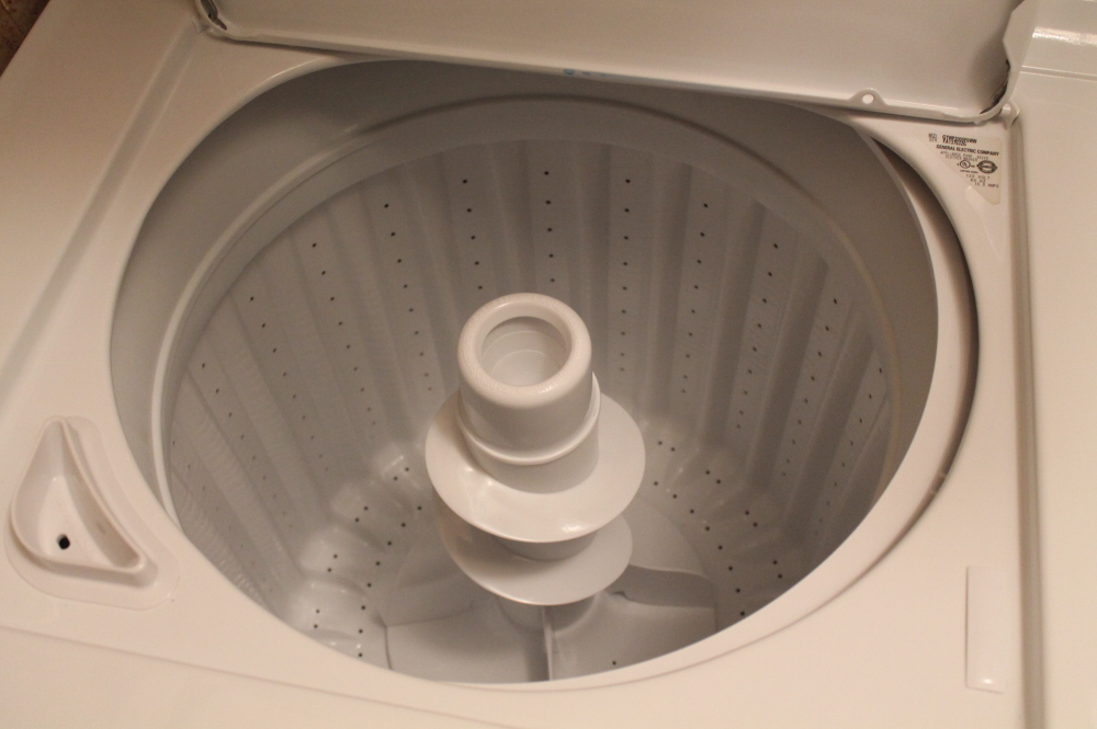

BTW, a replacement machine was purchased. It was on clearance as it was a floor model. At the time considering the cost of the parts and the effort in repairing the Amana, it made sense to just put the Amana out on the curb - but,
turns out this thing (pictured below) is a GE made by the POS corporation. The only thing it is capable of doing is tying sheets into knotted balls of fabric the whole time deciding what it "feels" is hot water, warm, etc. And, the "super" water level stands at about six inches from the bottom of the tub. The minute the Amana is returned to it's rightful place in the laundry room, it's going back! |

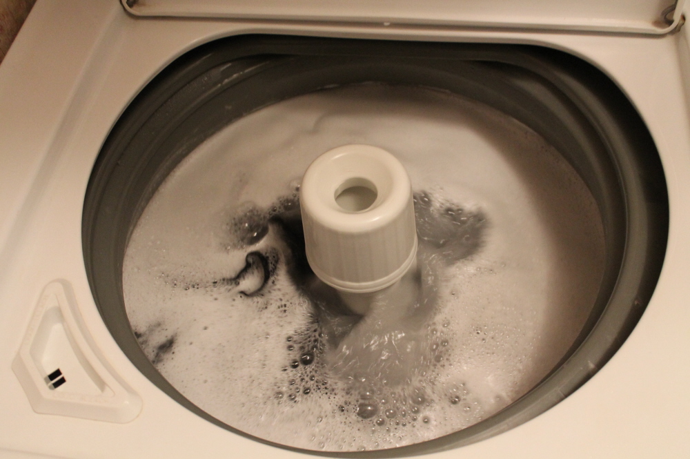

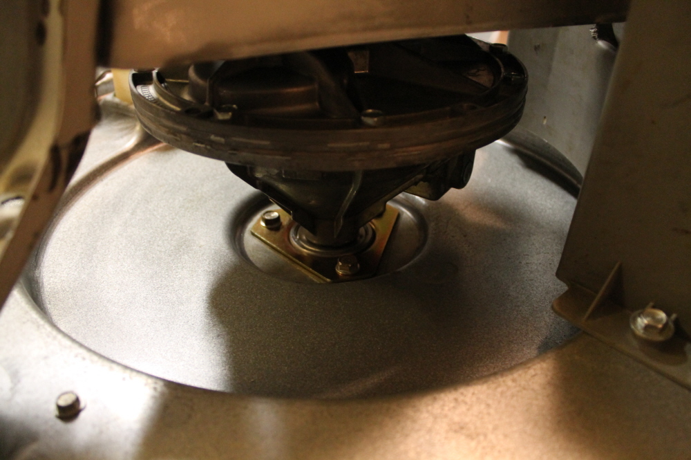

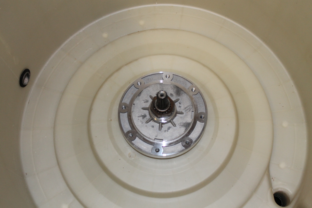

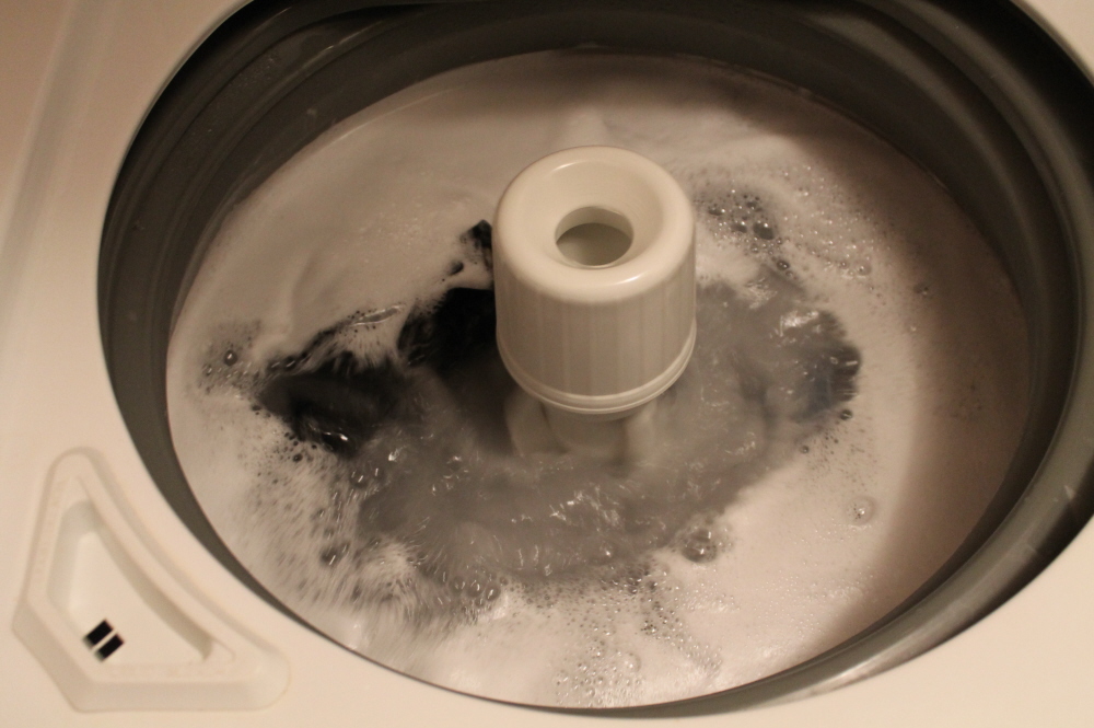

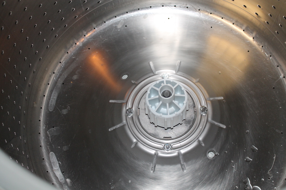

The machine sat now until the following day when I ran it through the prescribed procedures to lube the seals, and to allow the sealant to cure. Then the machine got a water leak test, and operational test on both speeds. So far, everything is working just fine.
Moved the GE out, and re-installed the Amana. You'll see a slight color difference on the dryer if you look closely. That's because I got it out of the garbage. It replaced a 1988 TOL GE that lasted longer than it's mate, a Filter-Flo. I put a new motor in the Amana dryer (which is why it was thrown away) and it's been good ever since. |

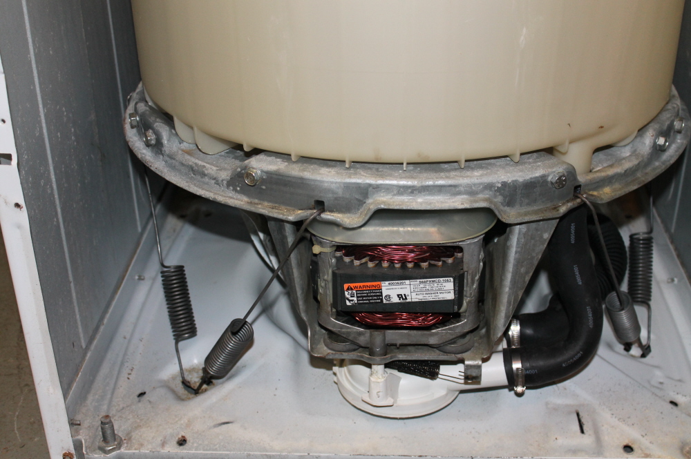

Now, I had known for a while that the bearing/seal was going out. It was just a matter of time NOT being available to investigate the repair, blah, blah, blah...
So, here is what I THOUGHT had occured. That bearing had finally gotten to the point where it had caused enough drag that the extra effort caused the motor to overheat and the thermal thingy kicked out. Not the case. The motor is fried. Once it gets heated up, spin action is slowed, and when the thermal protector kicks out, it is preceded by a loud "buzzing" - that of the motor trying to start up but can't. A new motor has been ordered. I think when it comes in and is installed, I might do a video of the operation of this machine if you care to see it.... I'll check back in, Rick |
