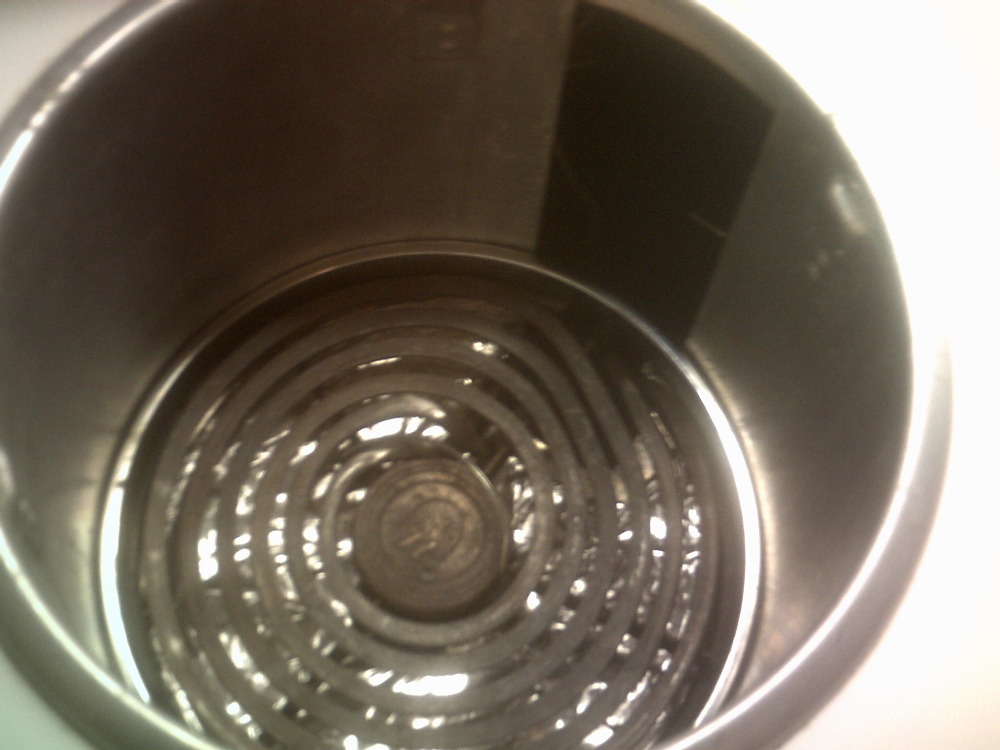

Post# 735120 , Reply# 2   2/14/2014 at 01:43 (3,394 days old) by norgeway (mocksville n c )
My Norge
Has a dual duty unit, its great for boiling pasta or slow cooking a roast, I think what makes the deep well cooker handy is, 1 its safer, you cant accidentaly tip over the pot, and 2 you can see into it better, especially if you are shorter, In the mid 50s GE and Hotpoint made a deep fryer immersion unit that really worked well, it went down into the pot which of course was about 1/2 full of oil, it worked just like a commercial deep fryer.An outlet on the back splash of the range supplied the power.

Post# 735126 , Reply# 4   2/14/2014 at 02:16 (3,394 days old) by norgeway (mocksville n c )
The Norge ..
Has a 8 inch unit!!

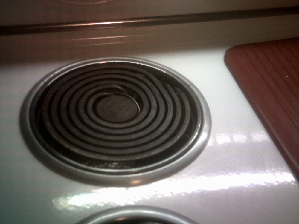

Post# 735127 , Reply# 5   2/14/2014 at 02:17 (3,394 days old) by norgeway (mocksville n c )
Here is how..
You lower it.
Post# 735128 , Reply# 6   2/14/2014 at 02:18 (3,394 days old) by norgeway (mocksville n c )
Low
Position..

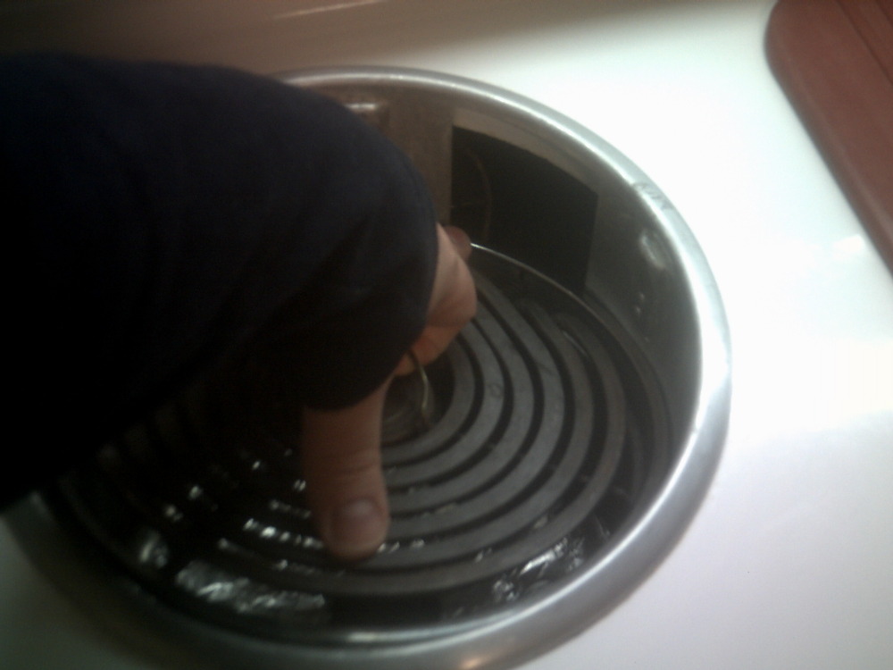

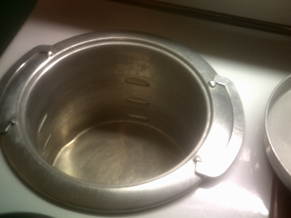

Post# 735129 , Reply# 7   2/14/2014 at 02:20 (3,394 days old) by norgeway (mocksville n c )
And with..
The pot in place, I also have a Presto deep well pressure cooker, it came with a Kelvinator, but it fits the Norge fine.

Post# 735154 , Reply# 9   2/14/2014 at 06:33 (3,394 days old) by danemodsandy (The Bramford, Apt. 7-E)
Bill:
danemodsandy's profile picture
The pot for your stove was indeed special. It fit the well exactly, and had specially-contoured handles that made it easy (and safe!) to lift the pot from the well's burner. Here's a shot of the correct pot, on a GE Stratoliner from 1948; your range used the same part:
Post# 735155 , Reply# 10   2/14/2014 at 06:46 (3,394 days old) by danemodsandy (The Bramford, Apt. 7-E)
And Here's....
A shot of one of these pots sitting in the well of a 1948 GE Airliner. As you can see, it sits fairly flush with the cooktop, not causing any interference with the use of other burners. These pots are medium-weight aluminum, with a Bakelite handle for the lid:

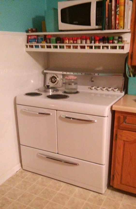

Post# 735266 , Reply# 22   2/14/2014 at 19:27 (3,394 days old) by classiccaprice (Hampton, Virginia)
classiccaprice's profile picture
My 1950 Frigidare has one, though I had to replace mine with one out of a 1947 model. It works well, but I agree a regular burner would be more useful. There are some good recipes for them though. I really like the Thermiser recipe for custard.
