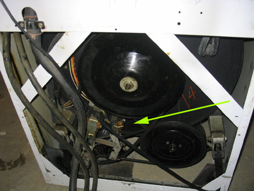

Hey, it's home! But I'm going to need your guys' help with this one, I'm afraid I'm over my head with this baby. My bud Ben and I hauled it down the basement stairs (HEAVY) and gave it a test drive. Everything appears to work, sans the timer. Am I detecting a trend? But, it looks like the spring that counterbalances the door is just hanging inside, I don't see where it connects to (thus no weigh-to-save). And note the two rusty rods sitting in front of the machine, any idea where they go? The tub appears to "sag" at the opening, maybe just tired overhead springs? While it's running, when it gets to any of the rinse positions where the tub needs to pick up speed, the solenoid from hell (see the arrow) engages, but buzzes continuously, loud enough to wake the dead! Continuous pressure with a screwdriver takes the buzz out. Are these AC solenoids, or DC? Reminds me of ripple getting into a DC relay like a failed diode. Any Westy experts? This guy looks like a handful! ![]() |

I was wrong and I want to correct myself BEFORE UNI does or I'll be in deep detergent! This is not the flush mount door Pearl Bailey model. Those rods look like shipping braces to me, the tub is offset down from the door, they came like that from the factory. And AC solenoids will actup and jitter if the plunger can't slam completely down inside the body of the solenoid because of: 1) they are dirty OR 2) a metal tang on the plunger is bent 0R a wire is getting caught between the plunger and the body of the solenoid. Try cleaning the solenoid (WITH THE MACHINE UNPLUGGED AT ALL TIMES). Nice machine if the tub bearings are good it should be alot of fun to play with for a long time. cheers jet |

Hi, My later 70's Westinghouse Spacemate washer buzzed VERY loudly during any spin/drain activity...which was enough to raise the dead like was told. I tried playin with the solenoid and lubing/cleaning the old one and ended up just springing for a new one, and was fortunate enought to find a NOS replacement solenoid i believe that it was less than $50.00 at the time? It wasn't a difficult repair, but when replacing things I installed the flexible driveshaft wrong and it made this horrible whiring whipping, clapping noise...so you must be careful to replace it as instructed.Please note this as it happened and it almost cost me another pump due to my "brains child hands cum" method of fixing things then. If you do it get a repair master or at least a reprint from someone so it goes off well... The weight to save thing was answered correctly as far as I can tell,mine operated kinda jankiety until I fussed with it then never had another issue. And yes every Westy FL that I have seen with the buggy spring (upper)/tong-ear(lower) suspensions sags quite a bit where newer FriGeMore versions, or even earlier pre 63' versions did not do so; or not nearly as much anyway. This was at least a 1964-94 year issue where the door was like on your machine that had the supension described rather roughly by me, or the four strut suspension like the older or newer machines. And heavy!!!!...NO kiddin...did you not see the two HUGE concrete blocks, used as the inertia stabilizers?..One sitting on the top of the tub, then the other riding on the lower front of the tub....NO WONDER WHY THEY WEIGH 300+ lbs. I also replaced the upper springs and the metal tab ears as well as when I get my set they were bent and looked saggier than most that I remember. This is caused by consistent overloading and misuse. I knew the family that traded in this set when I snapped them up...and they were a strictly "maintenence optional clan" I would suggest this for you and you may find that the tub raises a bit...and it wouldn't hurt for longevity purposes. Timers are still available as I just found one from mine rebuilt thru an appliance part outlet here in town. The times was rather priey @ $130.00 more or less...but it's worth it since it's my only Westy set. If you find the dryer match you will have a world class set that still washes as good if not better than many contemporary machines yet being made...maybe they have a slower spin speed than today's top-load or even front load varieties, but they still will do an awesome job for you....Good Find!!! Chad |

Looks like the pump on this one only operates when commanded. Turns out the pump solenoid is what's faulty (and waking the dead). When it's engaged, it pulls an idler against the drive belt, the idler in-turn connected via a flexible shaft to the front of the machine where the pump is located. So the question is....where might I find this pump solenoid? I really want to see this thing in operation! Oh, and I was able to bypass the door switch for the lamp so I've got continued operation. The timer works for parts of the cycle but not all of it, internal contacts that control the motor? |
