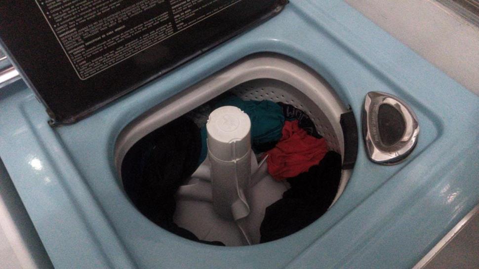

5
With the restoration complete I've run about two dozen loads through the washer, and for the most part everything is working great. The top outer tub seal will leak just a tiny during spin on loads that are somewhat out of balance, and the brass elbow someone knocks against the outer tub.
Otherwise, mechanically this machine sounds about as good as they come. At some point I'll try to film a full cycle clip and load it up to YouTube, but for now here's a great clip of the Ultra Clean doing what it does best - washing some towels! |
