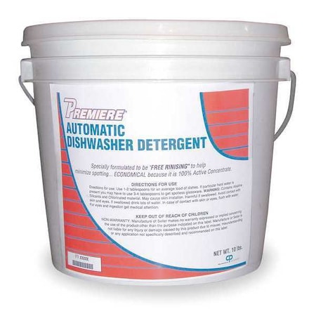

Chlorine based detergents will help with coffee/tea stains. Wash cycles on the older dishwashers are short, and modern detergents with enzymes and not chlorine bleach need longer main wash cycles. Plus chlorine based detergents help to keep the inner tank white. |

I suggest using a powdered detergent with phosphates, such as Cascade Fryer Boil-Out or something similar. You can't get plain old dishwasher detergent with phosphates anymore, but retailers that carry restaurant and institutional supplies will have products such as the boil-out powder. Since your machine runs much quicker cycles than modern ones, phosphates are necessary, particularly if water is hard in your part of the state. |

I'd also spring for a new control switch since there are some currently available on Ebay https://www.ebay.com/itm/NOS-FSP-Whirlpo... . These can get wonky after heavy use, obsoleted many years ago as well. Most parts of this machine can be obtained from other models except for that timer and switch. The screen on the fill valve can get plugged up overtime, especially if you don't have a water softener, which will underfill the dishwasher and hinder its performance. Next time you run the dishwasher and it has completely filled up on the main wash, stop the dishwasher and let the water drain for a minute or two. Pull the lower rack out and take a picture of the water level near the filter. We'll be able to tell you if the water level is correct. As stated above, these dishwashers have fast cycles and were designed for a chlorine based detergents, lots of hot water, and brute force. Tabs and pods will sudslock these machines and give poors results. Cascade fryer boilout is the only way to wash in these older machines www.amazon.com/Cascade-Ph... |

As others have stated, the 20 series KAs were made between 1981 and 1984. I've been daily driving a KDS-20 now for about 5 years - two years in a previous house with hard water, and thee years now with mechanically softened water. Prior to that I was using a KDS-17A for about 5 years. While the KA was minty when I got it, the wash arm support and wash arm required replacements and were outfitted with NOS parts. This dramatically improved cleaning as the original wash arm support was binding on the arm. Who knows if the abuse of hard water did it in. After trying several different variations of dishwasher detergent over the years, this is the combo I swear by - a Costco Kirkland pack in the pre-wash side of the dispenser, and some old-school Cascade powder (branded Cascade Professional) in the main wash dispenser. I can finally put the scroungiest dishes in the KA, even let them set for a few days, and things will come out crystal clear clean using Heavy Wash. The enzymes of the Costco packet work well on the already pre-washed dishes during the Heavy Wash cycle, and then the long wash with the chlorine based Cascade really finishes things off nicely, even in the absence of phosphates. Make sure the water being fed to the KA is pipping hot. If you already have soft water in your home, you may want to try to find some of this chlorine based Cascade before going with the big guns others have suggested - Cascade Fryer Boil Out. I had to order it online in bulk as I'm unable to find any chlorine based detergent on a shelf, locally, and it was still quite a bit cheaper than the Fryer Boil Out. Good luck with your Hobart KitchenAid! Ben |
