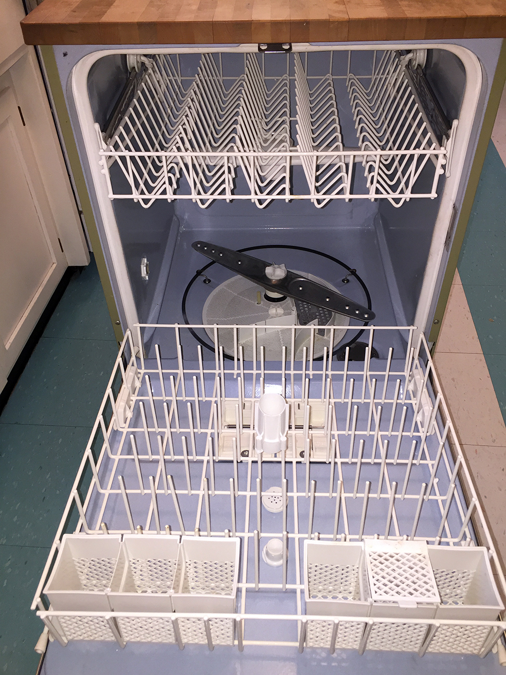

So my 1957 picture-window KitchenAid dishwasher after 15 years of use has developed a leak so off to the basement it goes for a few months for a complete overhaul.
As a "temp" I just found this never used, still in it's box Bottom of Line Whirlpool dishwasher from 1985/1986. I will be fun to use for a few months and then off it goes as it doesn't go in my kitchen. At least there is no woodgrain on it! All I saw in the FB Marketplace posting was a picture of the box so I had absolutely no idea what was on the inside. I brought it home and ran it's first load last night. Everything came out clean albeit a noisy little machine with minimal outside sound insulation. |

Post# 1162960 , Reply# 33   10/31/2022 at 21:19 (543 days old) by Unimatic1140 (Minneapolis)   |   | |
Buzzzz the NOS dishwasher is now dead! Barely 70 days use and today the motor just hums and in about 2 seconds cuts out on the motor protector. I suspect it's the motor relay. Does anyone know if a Kitchenaid DW or GE washer motor relay will work in this machine? I'm making an assumption that this DW has an external motor relay I haven't gone in an looked yet.
If it's not the relay then the motor is locked up for some reason, although I kind of doubt that is the problem. |
Post# 1162962 , Reply# 34   10/31/2022 at 21:53 (543 days old) by combo52 (50 Year Repair Tech Beltsville,Md)   |   | |
Likely has a locked up or stuck motor, relay is in console but is not likely bad, I have boxes of them if you want me to send one.
Carefully try turning the fan inside the bottom of motor to see if it is locked up, you can use an Allen wrench if you want.
Might be time to up-grade to a Power-Clean module.
John L. |

Post# 1162981 , Reply# 37   11/1/2022 at 14:18 (542 days old) by Unimatic1140 (Minneapolis)   |   | |
So I investigated this issue. John I could not find any motor fan at the bottom of this square motor however when I had the motor out I found a water slinger on top of the motor that I could have tested turning the rotor shaft with. So first I took off the spray arm and diffuser and the motor started to work again. There was nothing unusual like foreign waste under the diffuser so I'm not sure what was going on.
What confused me about the diffuser is it seems to have three parts the main diffuser top, a disk below that is aligned by little plastic dowel pins and a round rubber seal. It seems the plastic disk just sits under diffuser top and is not securely connected to the diffuser dowel pins same with the ring seal. I ended up having to take the motor out to reinstall the diffuser assembly because I couldn't turn it down without the disk and seal falling out and not being properly aligned. I did get it all back together and ran a test load, the first wash, rinse and second wash went just fine, it drained after the second wash and the motor was locked up again for the 1st rinse. I have no idea what is causing the motor to lock up. But now I can barely turn the shaft via the water slinger now. I suspect something in that diffuser may be defective. Update to thread: I just took the diffuser off again and took some pictures. Pict 1 shows that disk is stuck to the impeller preventing it from turning. Pict 2 and 3 shows the three parts. In Pict 3 you can see how the impeller has scraped up the bottom of the disk. I'm pretty sure that disk is not supposed to separate from the housing. I looked up the part number 301559 and that doesn't come up anywhere. I wonder if I can bond the disk to the housing? This post was last edited 11/01/2022 at 15:05 |
Post# 1163011 , Reply# 38   11/1/2022 at 19:53 (542 days old) by combo52 (50 Year Repair Tech Beltsville,Md)   |   | |
That white desk that’s under the top housing is supposed to be permanently heat welded in place, it came loose and fused on to the wash impeller.
Never saw this happen before that’s the fun thing about this business is always something unusual that you see every week.
Robert you can either glue or refuse it back together or I can send you the entire top of the pump assembly we have lots of them laying around I never saw nothing Anything ever happened to one, at least until you got one lol

Post# 1163021 , Reply# 40   11/1/2022 at 20:44 (542 days old) by Unimatic1140 (Minneapolis)   |   | |
Thanks John, yeah I used JB Plastic weld on the where the disk meets the dowels so hopefully that will solve the problem permanently. Thanks as always for the info and offer of a good used one!
