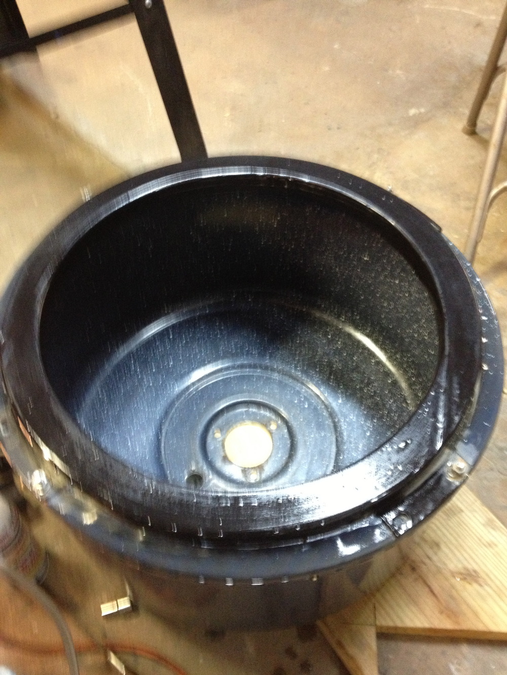

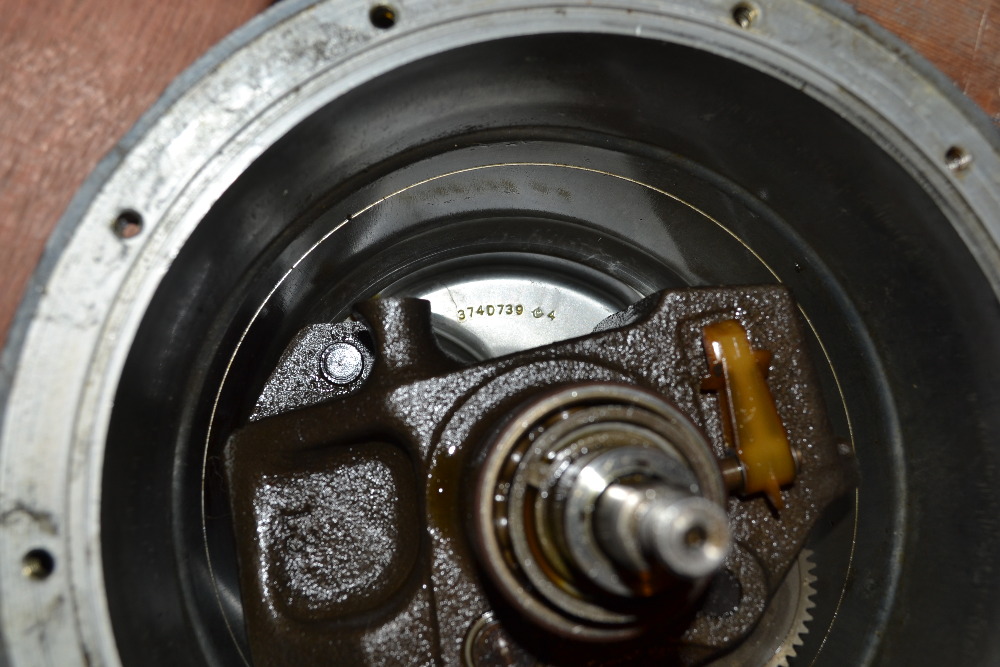

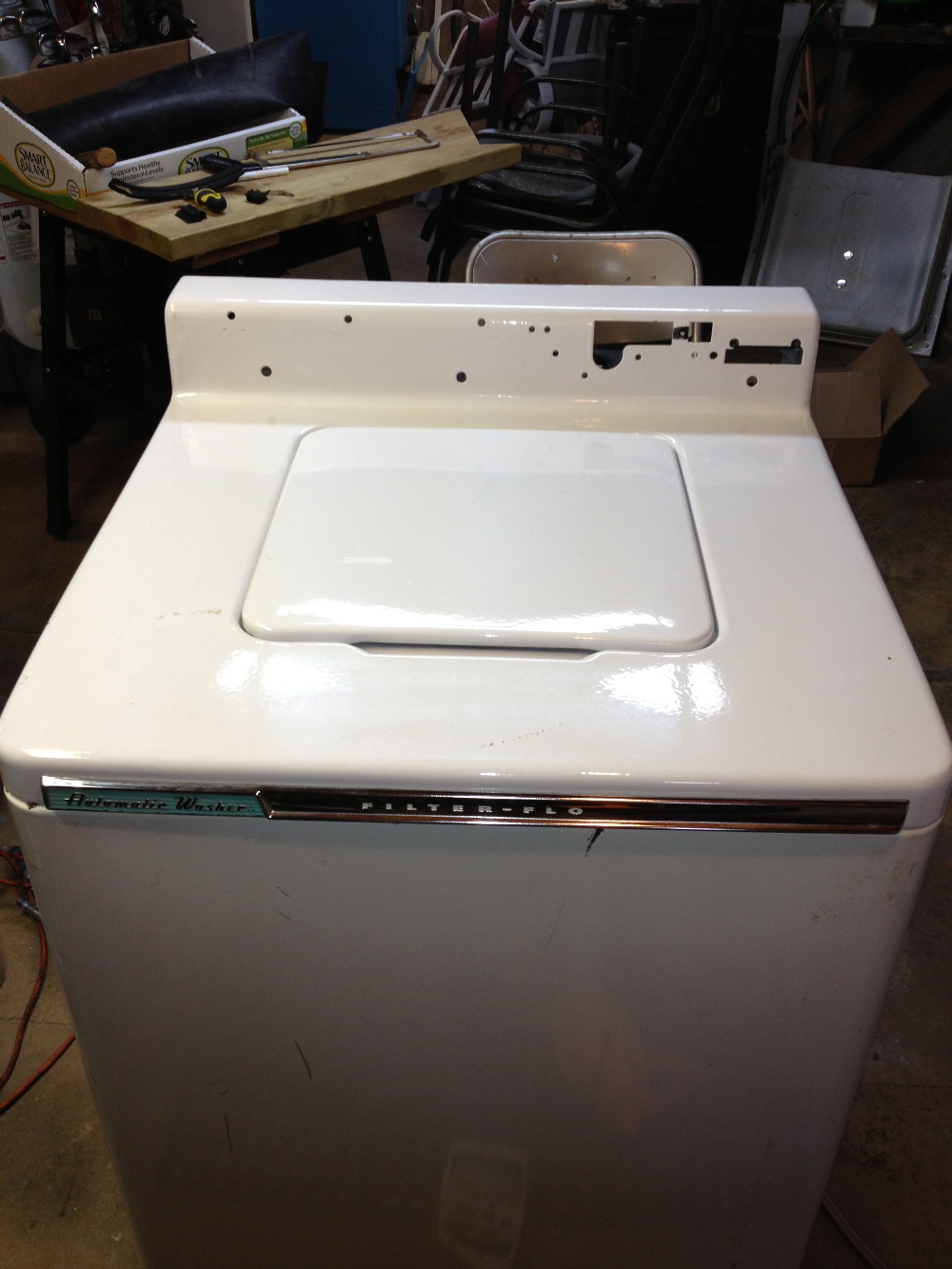

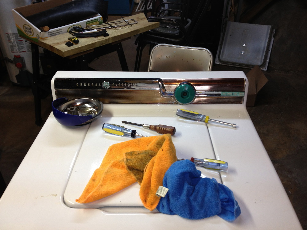

A 1956 GE Filter Flo goes back into service!

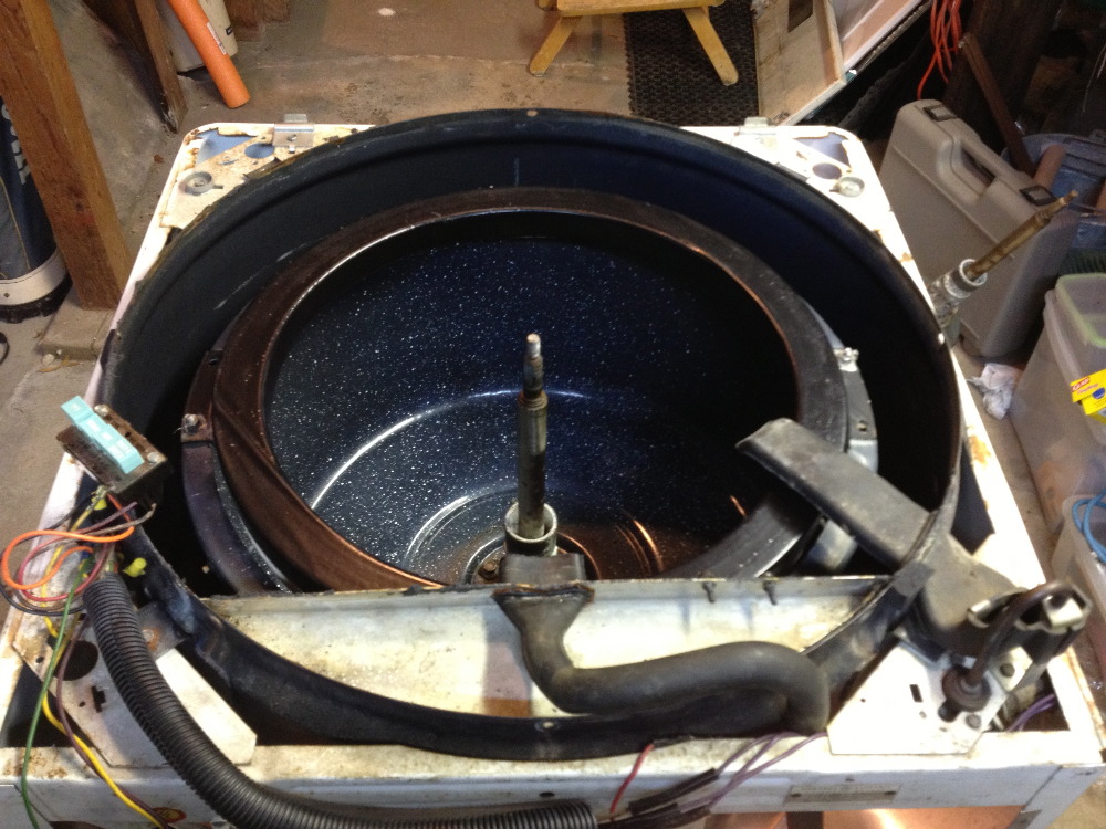

This excellent example is the machine I grew up with and came to me via Robert via Greg. As you will see in the diagnosis video she has the infamous GE Sympathetic Spin syndrome - considered by SOME as incurable-. She would spin out half her water from the tub on wash- no way to get clothes clean! Also you will see the condition of the pump another sore spot!
This post was last edited 04/02/2013 at 17:26 |
Post# 669893 , Reply# 1   4/2/2013 at 12:07 (4,041 days old) by Jetcone (Schenectady-Home of Calrods,Monitor Tops,Toroid Transformers)   |   | |

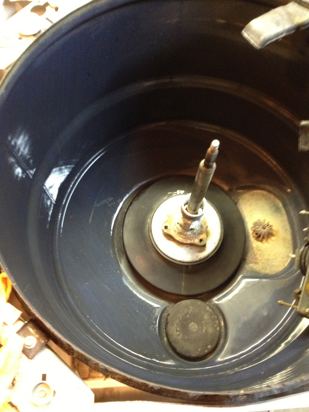

Post# 669895 , Reply# 2   4/2/2013 at 12:10 (4,041 days old) by Jetcone (Schenectady-Home of Calrods,Monitor Tops,Toroid Transformers)   |   | |

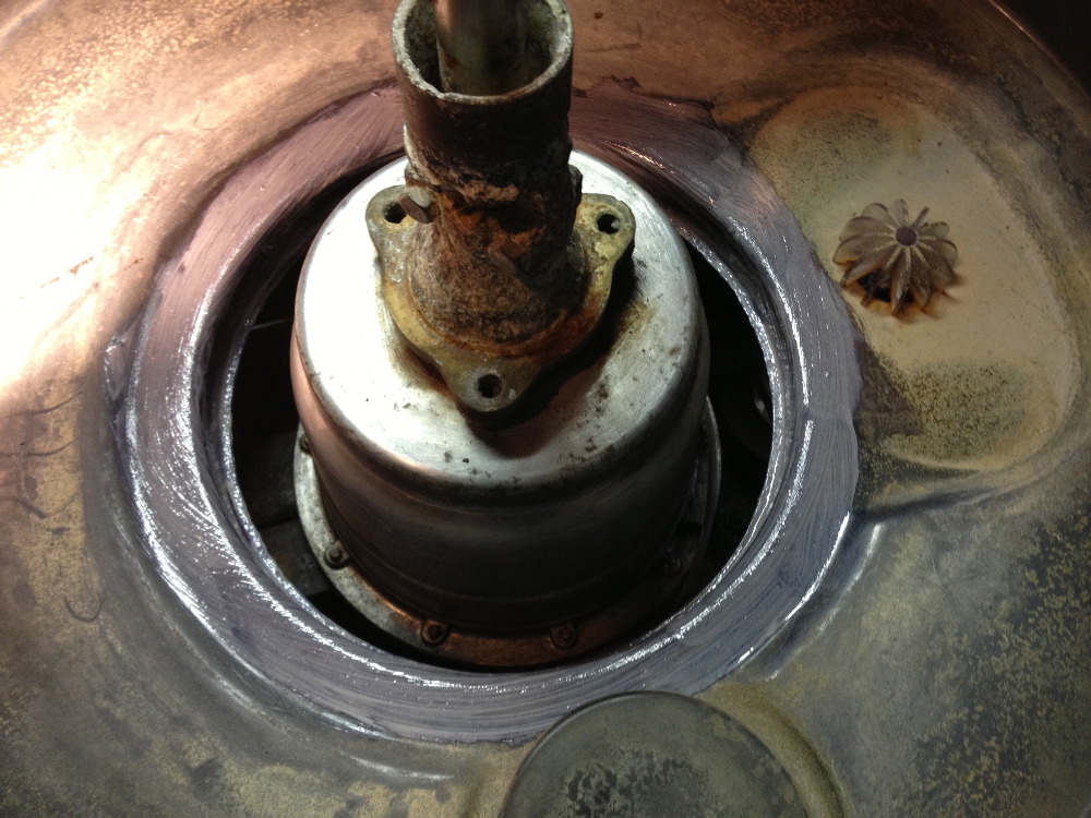

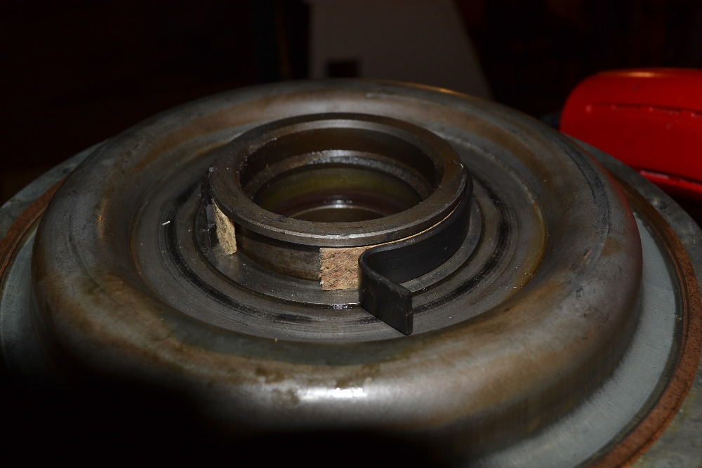

Transmission to get at the problem, there is a snubber inside which has wings. One direction it planes on the transmission oil for spin the other direction it dives down to contact the brake spring tang and brake to hold the tub during agitation. Here you can see the bottom removed and you are looking up into the tranny and can see the blonde snubber on the right. These gears haven't seen the light of day since 1956!
This post was last edited 04/02/2013 at 16:50 |
Post# 669896 , Reply# 3   4/2/2013 at 12:12 (4,041 days old) by Jetcone (Schenectady-Home of Calrods,Monitor Tops,Toroid Transformers)   |   | |
plate carries the brake spring and band. You can see the circular wear pattern under the brake tang, where the tub snubber has been pushing the brake lining around and around the center post. This is what generates "sympathetic spin". This post was last edited 04/02/2013 at 13:33 |

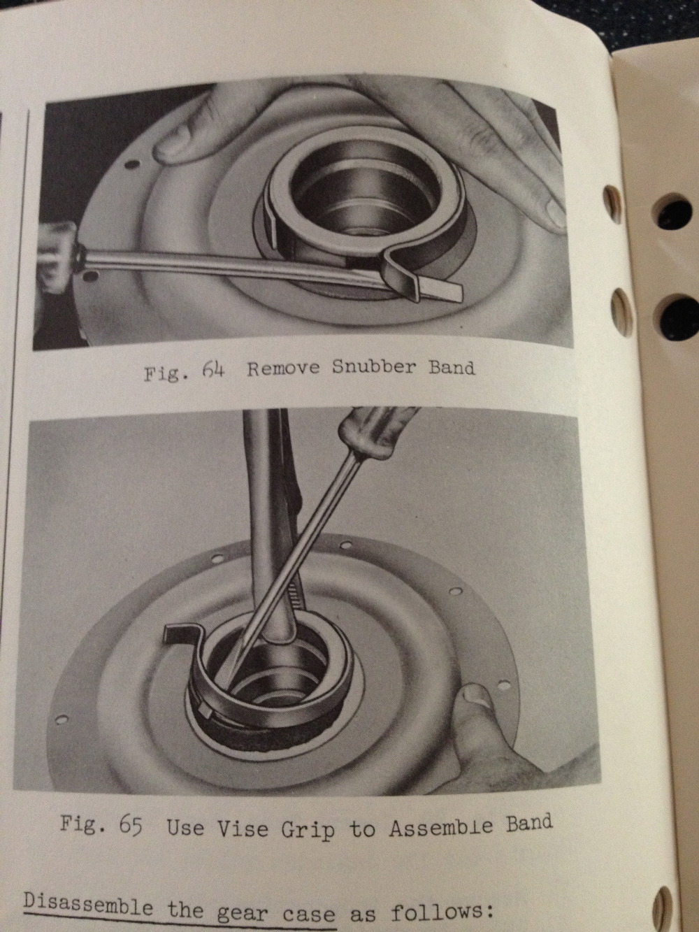

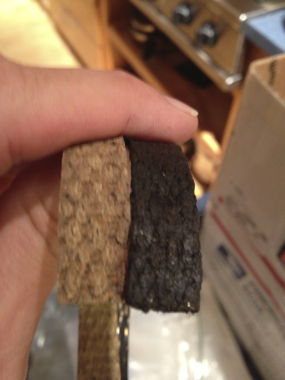

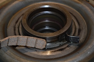

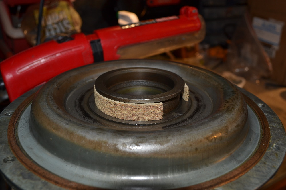

Post# 669897 , Reply# 4   4/2/2013 at 12:15 (4,041 days old) by Jetcone (Schenectady-Home of Calrods,Monitor Tops,Toroid Transformers)   |   | |

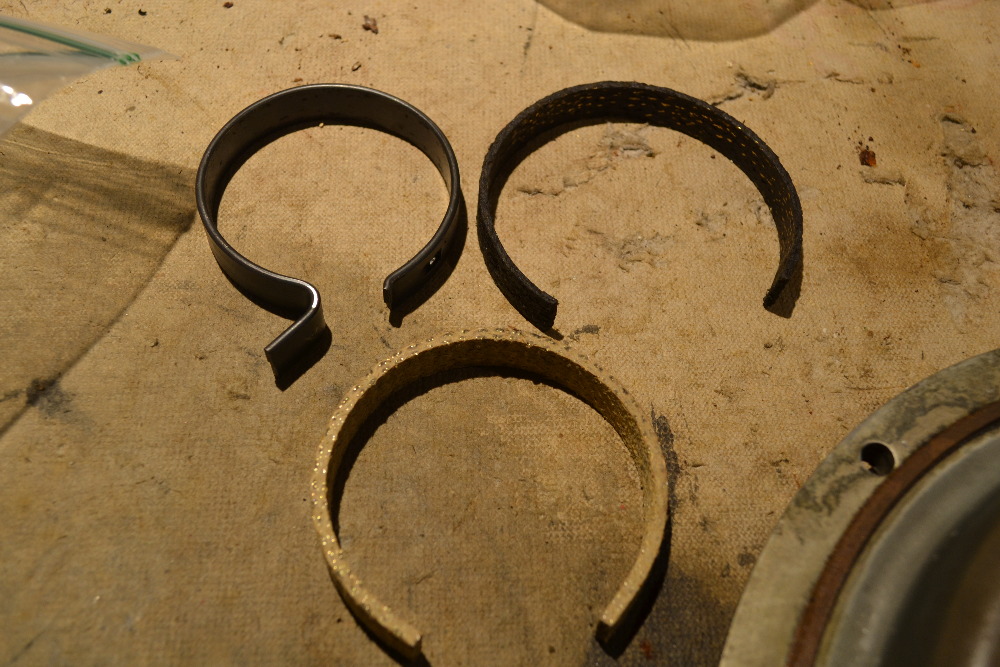

GE' s of this vintage is the brake band - made of brake material- wears down so that it becomes so thin that the brake spring has nothing left to grip resulting in the machine going into as Larry at MODERN puts it- "Sympathetic Spin"!
Here you can compare the new brake band I had made up to the original and note the thickness. |

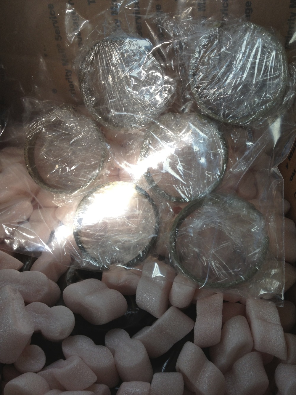

Post# 669898 , Reply# 5   4/2/2013 at 12:23 (4,041 days old) by Jetcone (Schenectady-Home of Calrods,Monitor Tops,Toroid Transformers)   |   | |
wonderful company down in CT who made these for me!
Timothy of TIMOTHY J. DORAN ALL FRICTIONS CO., LLC 131 FREESTONE AVE. PORTLAND, CT 06480-1819 PH.# 860-342-2001 FAX# 860-342-2084 INFO@ALLFRICTIONS.COM ALLFRICTIONS.COM I sent him the SM information and the base plate and part, He was able to fabricate perfect fit new brakes!! |

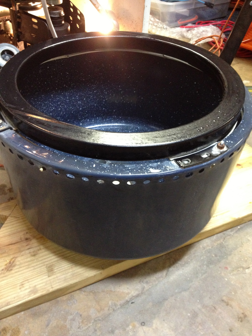

recharge the tranny with 44 ozs of Royal Purple re-seal and then install back into the machine. As you can see I have also taken the time to paint the rim with 3M Extend to inhibit and block the surface rust from growing. A cure overnite and she is ready for her boot! This post was last edited 04/02/2013 at 16:54 |

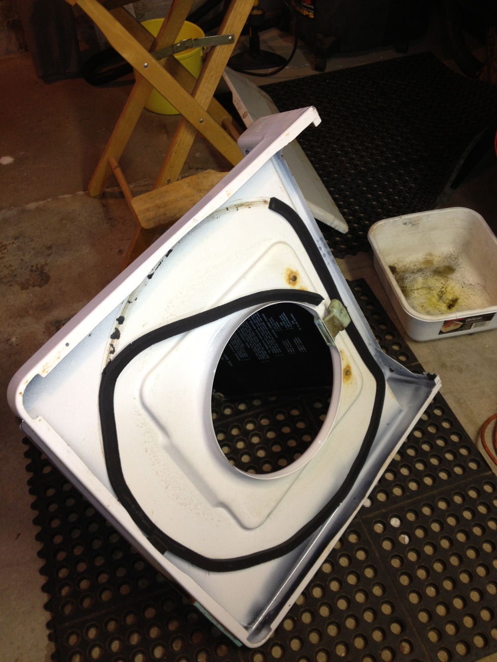

Post# 669911 , Reply# 16   4/2/2013 at 12:53 (4,041 days old) by Jetcone (Schenectady-Home of Calrods,Monitor Tops,Toroid Transformers)   |   | |

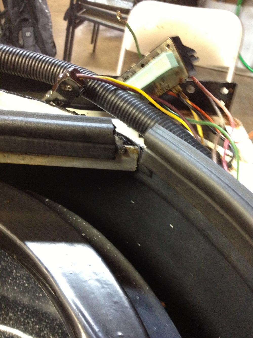

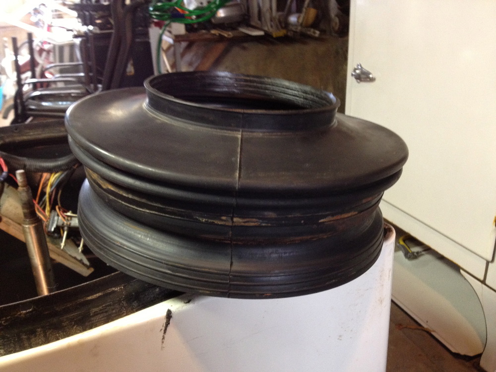

I was able to procure new tub gasket material from McMaster-Carr, it works great but as I was working off of old closed cell foam someone had installed in the past I was working blind and as you will see I missed a gap on the back near the the fliter-flo flume. DONT MISS This spot otherwise you will have water GUSHING out the back of the machine right next to the timer! NOT A GOOD situation!

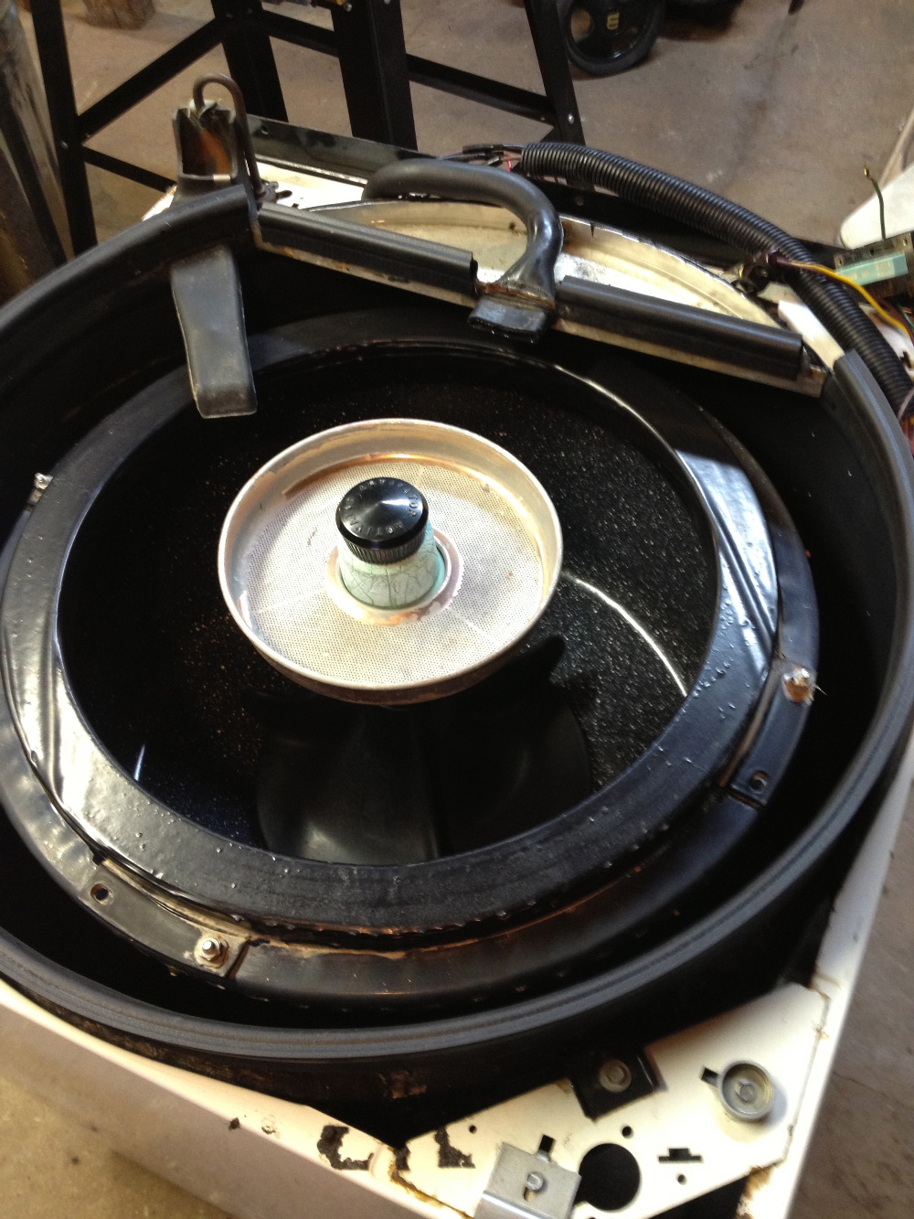

of the area I'm talking about. During spin the tub is CCW rotated [ much to Laundromats horror ] and water will mound up around the spinning tub and this gap is right in line with the wave of water!! If your pump is fast or your drain hose short you might get away with this but why would you?? It will release steam in wash to all the electrical parts if even if it doesn't shoot water on spin! This post was last edited 04/02/2013 at 17:10 |
Post# 669914 , Reply# 18   4/2/2013 at 12:59 (4,041 days old) by Jetcone (Schenectady-Home of Calrods,Monitor Tops,Toroid Transformers)   |   | |
so i was able to reuse that , I had to rebuild the water valve and then adjust the water switch. And of course that old pump HAD to go!

Post# 669915 , Reply# 19   4/2/2013 at 13:03 (4,041 days old) by Jetcone (Schenectady-Home of Calrods,Monitor Tops,Toroid Transformers)   |   | |
top is designed to slide over the tub gasket sealing the tub, so you can't use closed cell foam like this to repair spin leaks , a valiant try by a another club member but she still leaked. As you can see the foam will get pushed aside in the sliding process. The only thing that will work is new rubber gasket mounted on the tank top edge. This post was last edited 04/02/2013 at 17:12 |

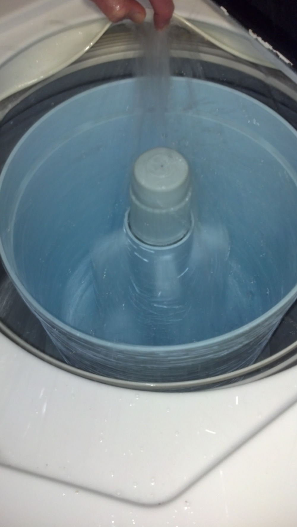

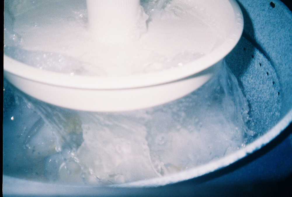

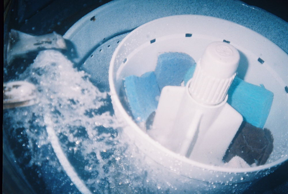

The dreaded water test! I tried it with water with success as you will see -- however there were "Doubting Thomases" who would NOT BELIEVE my success until THEY saw huge beach towels with water to put my work to the test. I'll let the video speak for itself....... This post was last edited 04/02/2013 at 17:17 |

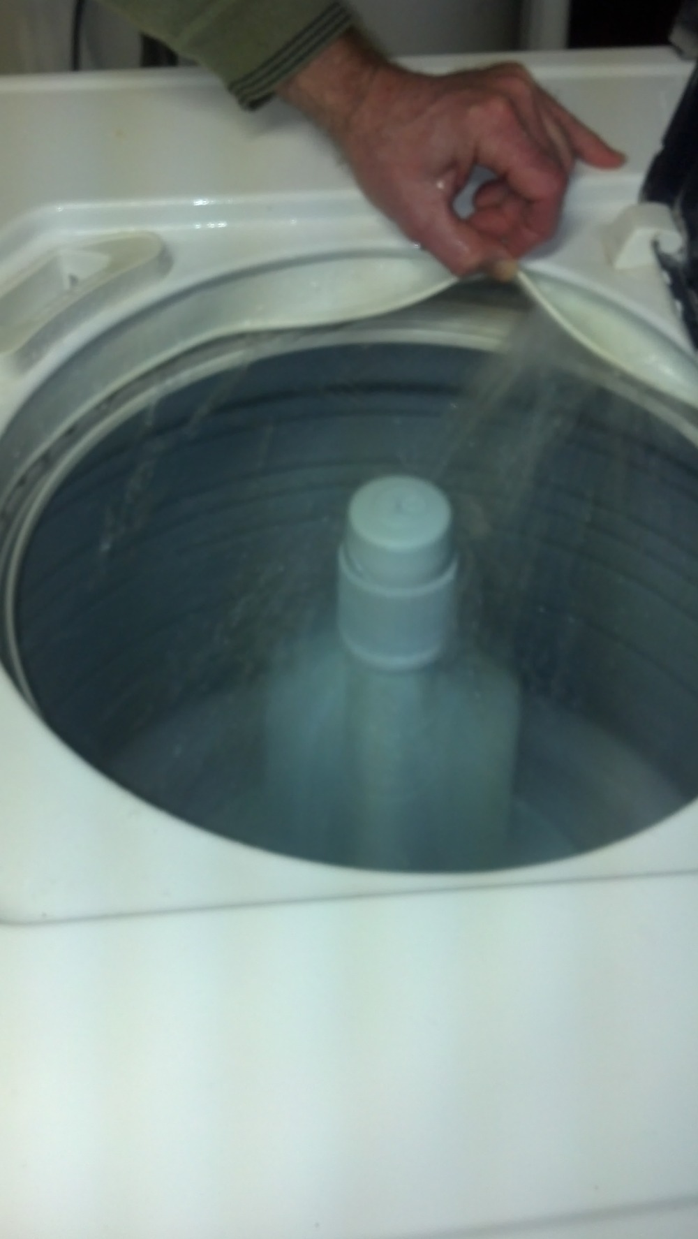

Post# 670140 , Reply# 43   4/3/2013 at 02:38 (4,041 days old) by Jetcone (Schenectady-Home of Calrods,Monitor Tops,Toroid Transformers)   |   | |
which you can see in#15 extends over the rim into the tub and it fills to overflowing into the outer tub. In pic#12 you see the outer tub and tranny, at the bottom at the 6 o'clock position the large black disk is a rubber diaphragm with a weight sensor under it. The outer tub fills, and water presses down on the sensor until the weight triggers the water valve shut off and wash begins. However for small loads there is a water saver button you can hit and start wash at any level.
