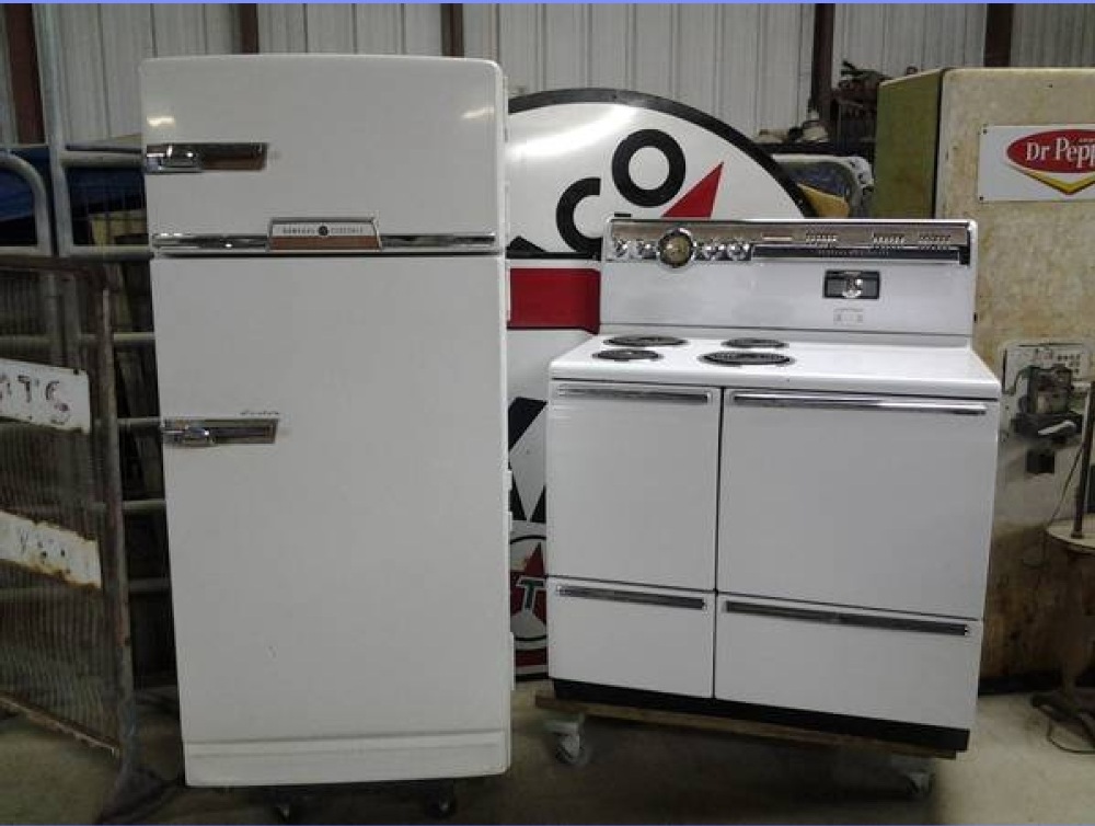

Norgeway and danemodsandy - here's some GE goodies.

The background--round Texico sign-looks like the swap shop out here in Chocowinity,NC!They have LOTS of signs!!!Sign guys--go to Chocowinity! |

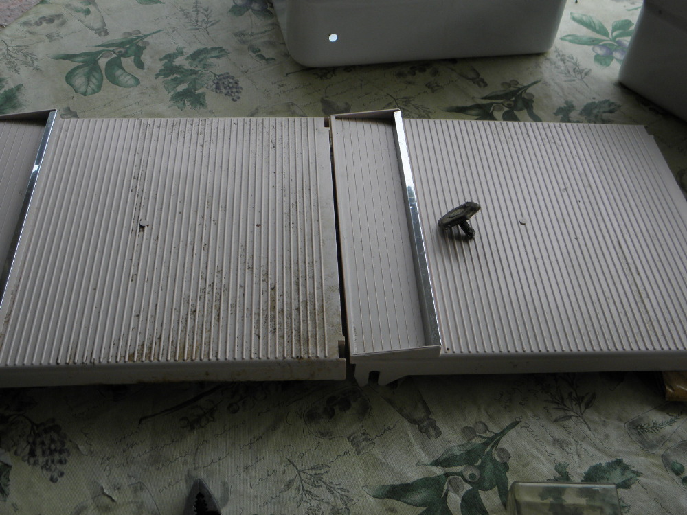

In the 60s, were rotating shelves common to certain brands or were they made in all competitive brands?
I remember a frig we had and I liked - had the rotating shelf or shelves, and a colored interior (not pink), but I have long forgotten whether it was Frigidaire, Hotpoint, or (kicking myself) what! ? |
Post# 679884 , Reply# 9   5/18/2013 at 06:45 (4,087 days old) by danemodsandy (The Bramford, Apt. 7-E)   |   | |
The turnaround shelves were a GE exclusive.
GE dropped them in the early '60s, because they were expensive to make. GE dealers were upset; the feature was beginning to gain really enthusiastic acceptance. As with many "midcentury miracles," there was a downside to turnaround shelves - a salesperson pushing a competing brand didn't have to work very hard to show Milady how much interior capacity was wasted by turnaround shelves that didn't touch the interior walls. And - speaking as someone who grew up with a '58 bottom-freezer Combination - they were not much fun to clean. This problem wasn't, strictly speaking, generated by the turnaround feature; it was caused by the need for strong, stamped aluminum shelves to make the turnaround feature possible. If a major spill occurred (and around my little brother, it happened frequently), getting all the spill cleaned out of the holes in the shelves could be quite the little project. In particular, I remember a pitcher of Kool-Aid that Little Bro knocked over while sneaking a swig in the middle of the night; he closed the door and walked away from the mess in an effort to hide his "crime." By the time it was discovered in the morning, there was a sticky goo all over everything that was lots of fun to get off. |

Agree - there was some wasted space, but it was easy to get to the items in the interior back(and I could be wrong on interior color). My mom gave up on keeping those shelves spotless - maybe not the best idea, but of all the refrigerators, I seem to remember and like that one the most, for ease of reach. Did they ever motorize? just kidding.

When my neighbor had a GE fridge like that, she would remove the shelving assembly every so often, disassemble it, and wash in the bath tub. |

![]() Phil, the pink interior would indicate 1957 as year of manufacture. That's the vintage of my Combination.
Pat's correct about the subject fridge being older than 1956. Not only does the exterior styling and white interior indicate earlier 50's vintage, but as Pat stated, a '56 would have had alnico magnets to keep the doors closed instead of latches.
While both pieces are very nice, $1,200 is kind of steep. I'm also concerned that in the ad, only the refrigerator is mentioned in the copy, but the price is still $1,200. |

![]() Because some equally clueless person told him they were of 1956 vintage.

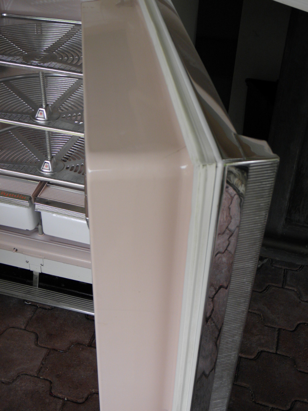

![]() The interior and exterior both needed a good cleaning, and the exterior finish came back to sparkling after going over it with some Meguiar's Car Cleaner/Wax. The few scratches and nicks disappeared with appliance touch-up applied very sparingly. I can't even find them anymore.
The fridge needed no major repairs. Both door gaskets were worn and torn on the handle side. I removed them and turned them around so they'd be on the hinged side and they're providing an adequate seal. I bought a new set from Larry at Modern but haven't bothered to install them yet, since it's not a quick process.
I also felt the cold control was suspect when I first put the fridge into service, but part of my suspicion was rooted in a lack of understanding for GE's temp control system. After having the fridge for about a year, the cold control finally got stuck "on" after defrosting and I had to replace it. I had ordered one from Larry along with the gaskets, so Nate came over and we both learned as we went through the replacement process, since it was a universal fit. The fridge has been functioning fine ever since, but I've learned to unplug it when defrosting the freezer since the cold control is tough to get readjusted back to optimum temperature after turning it all the way to the "off" position.
I still don't know what GE meant by "touch and the freezer door opens." Either they meant you don't have to yank it open like a latched door, or perhaps they were mistakenly referring to the foot pedal on a bottom freezer model.
My fridge is the smaller of the top freezer models. It's only 61" tall, which is perfect for its home in the laundry room here, which has a low ceiling. Total volume is 11.5 cf, which is why it only has two revolving shelves. I'm pretty sure the '58 model that Lawrence had was the larger size, which came with three revolving shelves.
Here's a shot of the fridge door gasket before I removed it, cleaned it, and rotated it around: ![]() |
