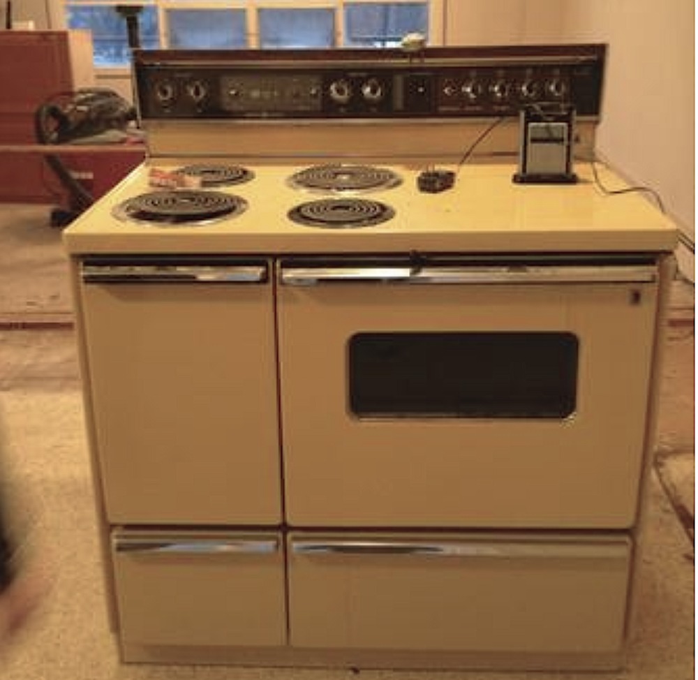

You probably have the correct time frame for this range; this was the period that GE was transitioning from pushbuttons to rotary controls. Sadly, GE's catalogs of the period do not show the 40-inchers available, so an exact date would depend on knowing a serial number.
The photo isn't the greatest, making it a little hard to tell if it's shaded Harvest or unshaded Harvest. The unshaded version would put it later in the decade. |

The consumer catalogs did not list the 40" models this late; however, I remember the local GE dealer having a 3-ring binder that had the catalog spec sheets for every GE product made. It was pretty thick. |
Post# 724132 , Reply# 4   12/31/2013 at 16:54 (3,860 days old) by danemodsandy (The Bramford, Apt. 7-E)   |   | |
If you will look carefully at the chrome handle for the big oven, you will see that there is a knob sticking out of the front of the range just above it.
That knob is the knob of the latch lever that locks the oven door during P*7 self-cleaning. That means this range has the self-cleaning feature, though finding whether it still works or not would take an in-person inspection. You're beginning to find out about one of the frustrations of this hobby - very often, the very appliance you dream of owning is too far away. Certain appliances really require that in-person inspection I just mentioned, and shipping costs a fortune. You just have to keep looking in your area, and you have to accept that there will be some frustration for a while. Trust me, someone out there has found out that their dream appliance is in Tucson - and they're too far away to afford the shipping. It's just the way it is. |

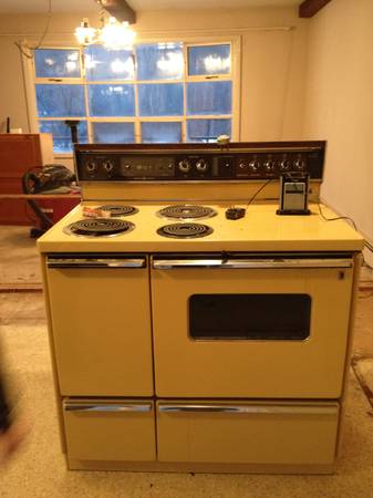

This range is a Model JCP68W in Harvest, and appears in my 1978-1983 GE catalogs. A description of the range's features:
"Deluxe, double-oven model with P-7 self-cleaning master oven that also cleans companion oven's removable panels; solid-state meat thermometer in master oven; Sensi-Temp surface heating unit with non-stick griddle; fluorescent cooktop light; digital clock, automatic oven timer and reminder timer; plug-in Calrod surface heating units." lawrence |

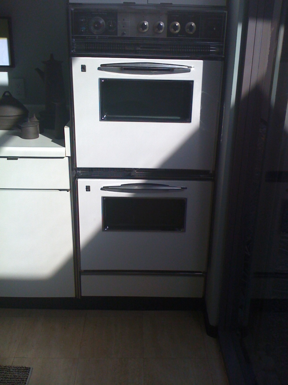

danemodsandy:
yes, our oven is the same as the white one you have pictured, but ours is in "coppertone". here is a picture of ours... as for the bottom oven door, when i slide the side tabs up (to reveal the window shield), that slot at the top of the oven door (on the inside), it does open when the window shield is fully up. so the problem can't be in the door, i don't think? i think it is more in the latch/hooks part?? ![]() |

Since the problem seems not to be in the window shields, I'm not sure what the problem is with your latch, but stand by - John combo52 should be along soon to advise.
Your wall oven was an extremely expensive one new - what I call an "RPO" appliance. "RPO" stands for Rich People Only. It is seriously, seriously worth your while to figure out what its problem is. Yours appears to be from 1973 or perhaps a year or two later - the clue is the woodgrain insert in the oven door handles. Earlier units - through at least 1972 - had brushed metal inserts. You will never find another wall oven that good. Ever. I hope we can help you restore it to full working order. JOHHHHHHHHHNNN! This post was last edited 01/01/2014 at 18:45 |

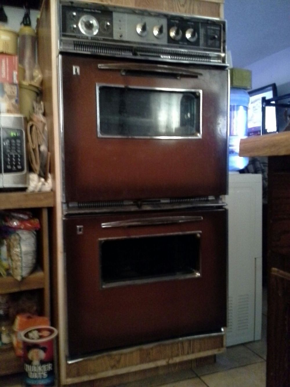

ok, i've tried to go through steps 1-7. i can do steps 1-3 & part of step 4 with no problems.
here is where i have the "hang-up", after i turn the oven set knob to "clean", i push the oven door latch release button in & hold it in the in position. while holding the oven door latch release button in, i try to slide the latch to the locked position but it only goes 1/2 and stops. i can't slide it all the way over into the locked position. i've put quite a bit of force into trying to slide it over but it won't budge no further than 1/2 way. i've even had my mom hold the latch release button in, while i try to slide the latch to the locked position but no go. my mom even said, "you're going to end up breaking it". so, i stopped. besides, i feel like i might have twisted my back slightly, trying to push that darned latch over into the locked position. you know, it's kinda funny when you think about it cuz i get "1/2 way" through step 4, where the latch will only slide "1/2 way" over towards the locked position!!! LOL..... i don't know.... it doesn't make sense cuz the top oven's door latch slides over into the locked position so easily. but the bottom oven just won't slide all the way over. and being bent over trying to slide the latch over, i am twisting my back! i even took all of my cast iron skillets out of the bottom oven, just in case the door did lock and i have to run the cleaning cycle. i don't want the iron skillets to be stuck in the oven for the cleaning cycle. but the oven door latch wouldn't slide into the locked position. it has to be something inside, where the latch comes out of, in between the top & bottom ovens? i don't know??? as for the top oven, i'm thinking about making some cookies, maybe oatmeal and following the directions to see how the cookies come out. then i'll raise the temperature by 25 degrees & make another batch of the cookies to see how they come out at 25 degrees higher. if they're still undercooked, i'll keep going up by 25 degrees until i can find the "just about" right temperature & see how many degrees off the top oven actually is. but before i can make the oatmeal cookies, i need to wait for my vintage sunbeam mixmaster mixer to come in the mail!!! so, i'm pretty excited about my vintage sunbeam mixmaster. and it's the "harvest gold" color too!!! HA HA!!! :o) |
Post# 724398 , Reply# 23   1/1/2014 at 20:21 (3,859 days old) by danemodsandy (The Bramford, Apt. 7-E)   |   | |
Christina:
It may be that there is something going on with the latch. But it is also possible that something is just not set right. This double-oven model uses only one timer control, which means that both ovens use some of the same stuff inside. It just may be that we're not doing something right. Either way, John will know. Betcha. P.S.: John's a nice guy, but he's a busy one. Might take him a few days to show up. Just be patient. :) |

Post# 865382 , Reply# 40   2/3/2016 at 16:39 (3,096 days old) by firedome (Binghamton NY & Lake Champlain VT)   |   | |
and the pic shown was just one that Sandy was using as an example.
