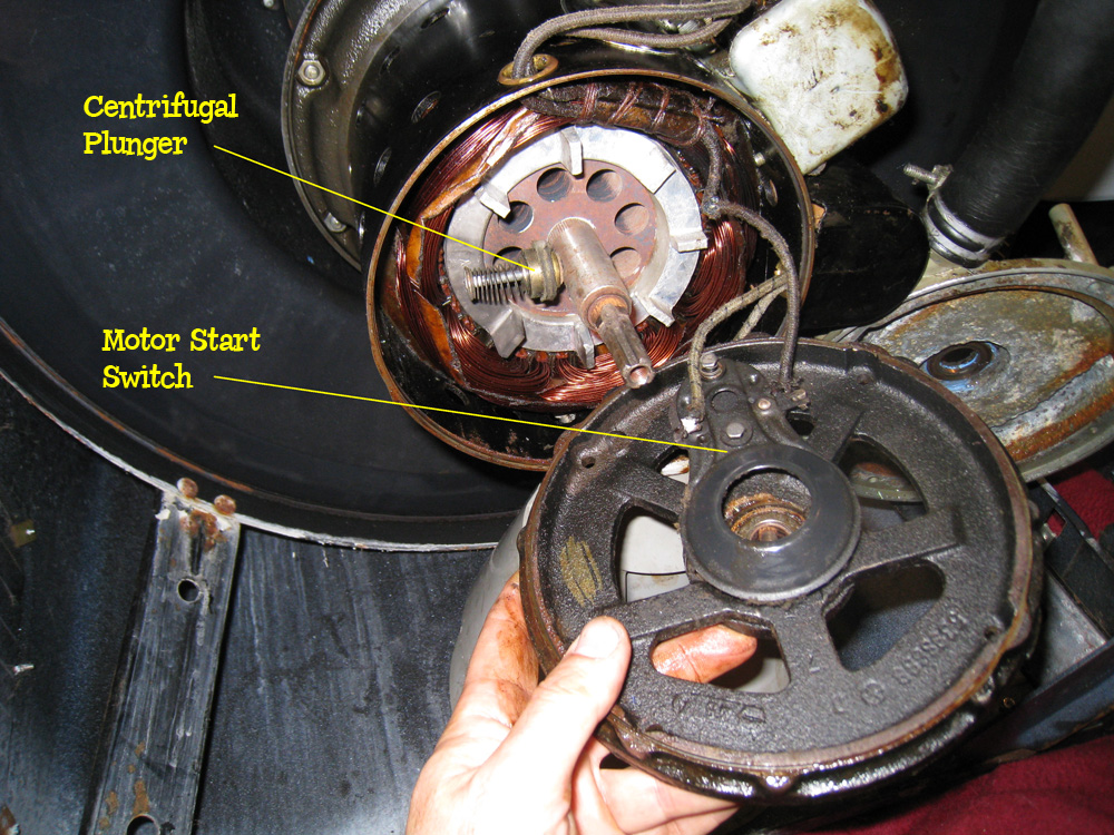

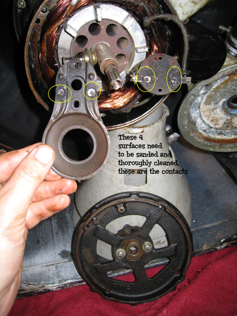

Post# 1174899 , Reply# 11   3/16/2023 at 11:13 (585 days old) by Unimatic1140 (Minneapolis)   |   | |
Sounds like then the internal start centrifugal switch of the motor is stuck and needs some cleaning and lubrication which means you will need to take the motor apart and investigate. I suspect the start switch is near the top of the motor which means you will need to carefully remove the impeller which is probably stuck on the shaft. You can test the motor by taking the two wires off the connections and place a test electrical cord onto the two wires and plug the cord in to see if the motor turns or not.

Post# 1178480 , Reply# 13   4/18/2023 at 23:36 (552 days old) by Delco1946 (Oregon)   |   | |
Took the motor bottom off. I could use guidance - what next/ what am I looking at? |
Post# 1178496 , Reply# 15   4/19/2023 at 07:08 (552 days old) by combo52 (50 Year Repair Tech Beltsville,Md)   |   | |
From your pictures and your testing it looks like you have some grounded shorted motor windings to start windings look particularly bad.
If you can find another motor or get a motor shop to rewind it, it might be fixable. This would not have damaged the timer and there’s no electronics of course to damage in this dishwasher lol. John. |
